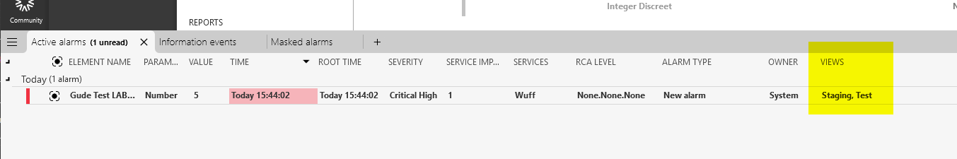

New picture on the staging (view "Test):
IIf I use "Staging", I can see the alarms:

If you click and drag the view where the services are to the Alarm Console, can you see the alarms there? (You may need to specify a time range, by default it selects only active alarms)
Cube is doing essentially the same thing in the background, so if this works, your code should work as well.
[edit] You can check your impacted views by right clicking the alarm console columns and selecting Add/Remove columns - Views
This will add a column listing all the views that are impacted by your alarm. If the test view is among them, then I see no reason why this would not work, unless you have custom view permissions set.

I have tested it again on the Staging server. Please see the updated thread with 2 new pictures. Could it be a version problem? In dll or DMA version?
