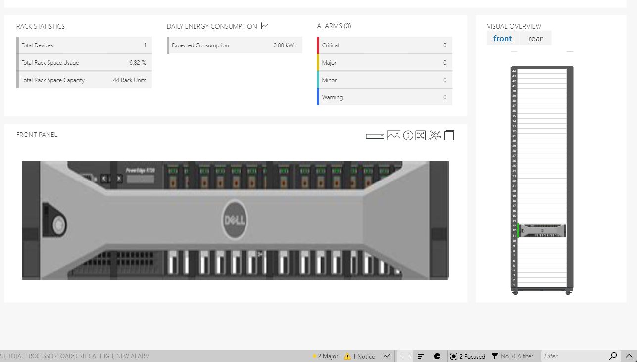

Edson Alfaro [SLC] [DevOps Advocate]1.78K Posted 16th October 2025 0 Comments
Based on Jan-Klaas answer, here is the result:
Edson Alfaro [SLC] [DevOps Advocate] Answered question 16th October 2025
