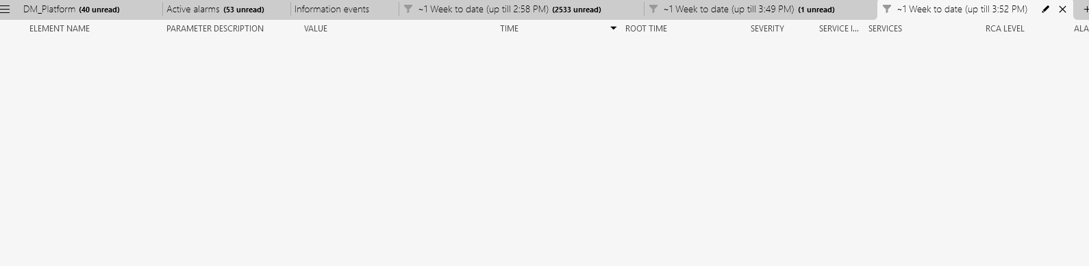

Zero Alarms fetched with filter showing count of 10 alarms

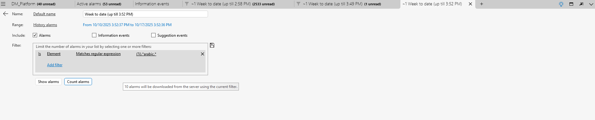

Is anyone able to explain why historical alarms count is showing non-zero number of alarms while the same applied filter returns zero alarms?

Sometimes it is not possible to put the complete filter in the query towards the database, and then client-side filtering is still being applied afterwards. The tooltip indicates how many alarms will need to be downloaded, and then it is possible there is some additional filtering client-side. This way it is possible zero alarms are left to show to you...

Thanks for the explanation. I now understand why I might be getting zero alarms, but I still find it confusing that count is not aligned with the number of fetched alarms. I believe there is a room to improve this, either by counting alarms client-side (that would most likely lead to the same processing times for both, count and show actions), or by adding the button tooltip explanations.
