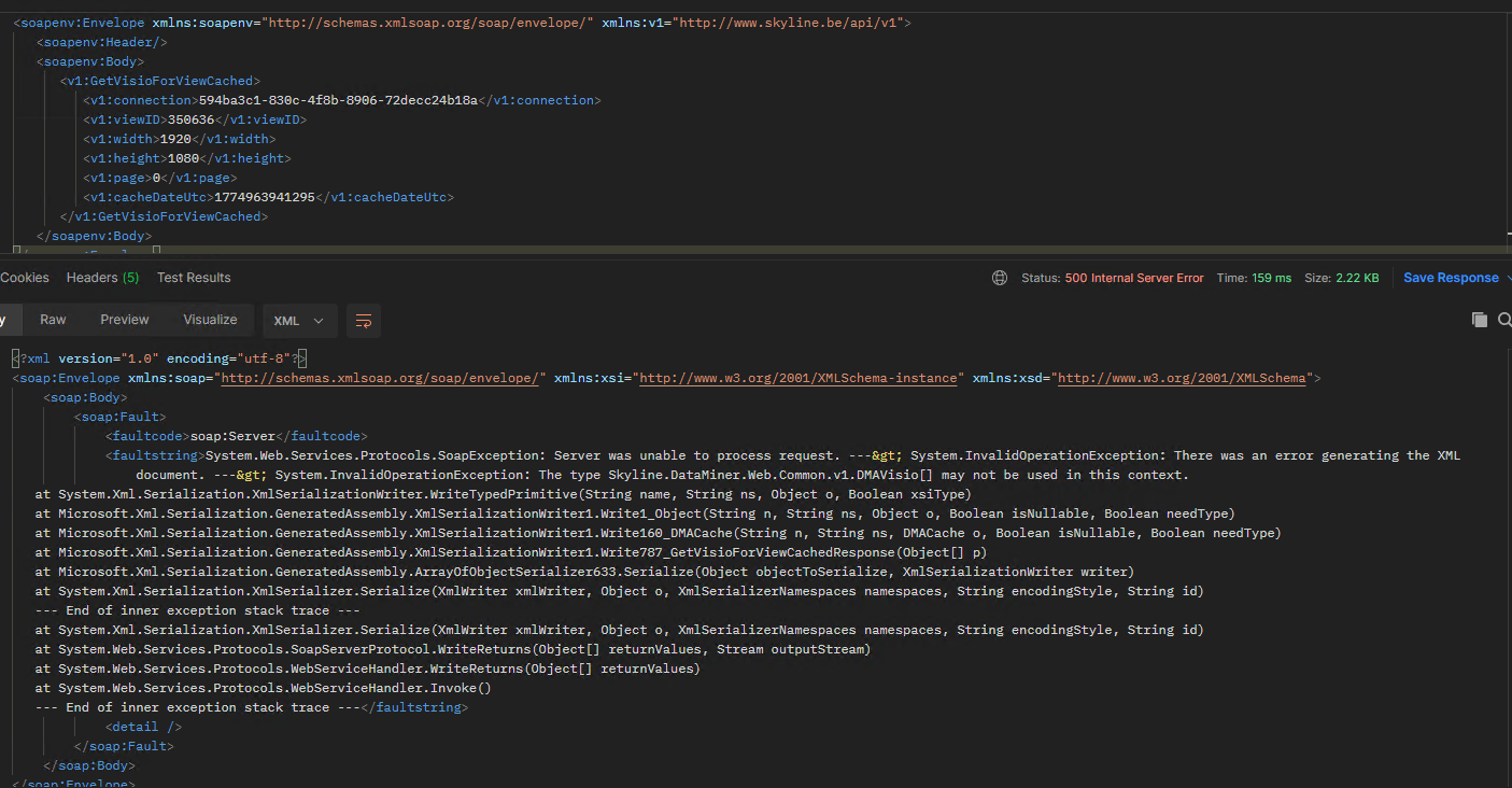

we are unable to get the WebServices v1 Method GetVisioForViewCached to work, we're getting an HTTP 500 Internal Server Error response (The type Skyline.DataMiner.Web.Common.v1.DMAVisio[] may not be used in this context.), while the same method and parameters does work for the Json interface and the Method GetVisioForView does work well with SOAP Interface.
Can anyone provide a working example for the GetVisioForViewCached SOAP method and/or replicate the issue?

There seems to be an issue with the serialization of the response when using the SOAP API. I have created a task for us to fix this, we will let you know here when a fix has been implemented.
