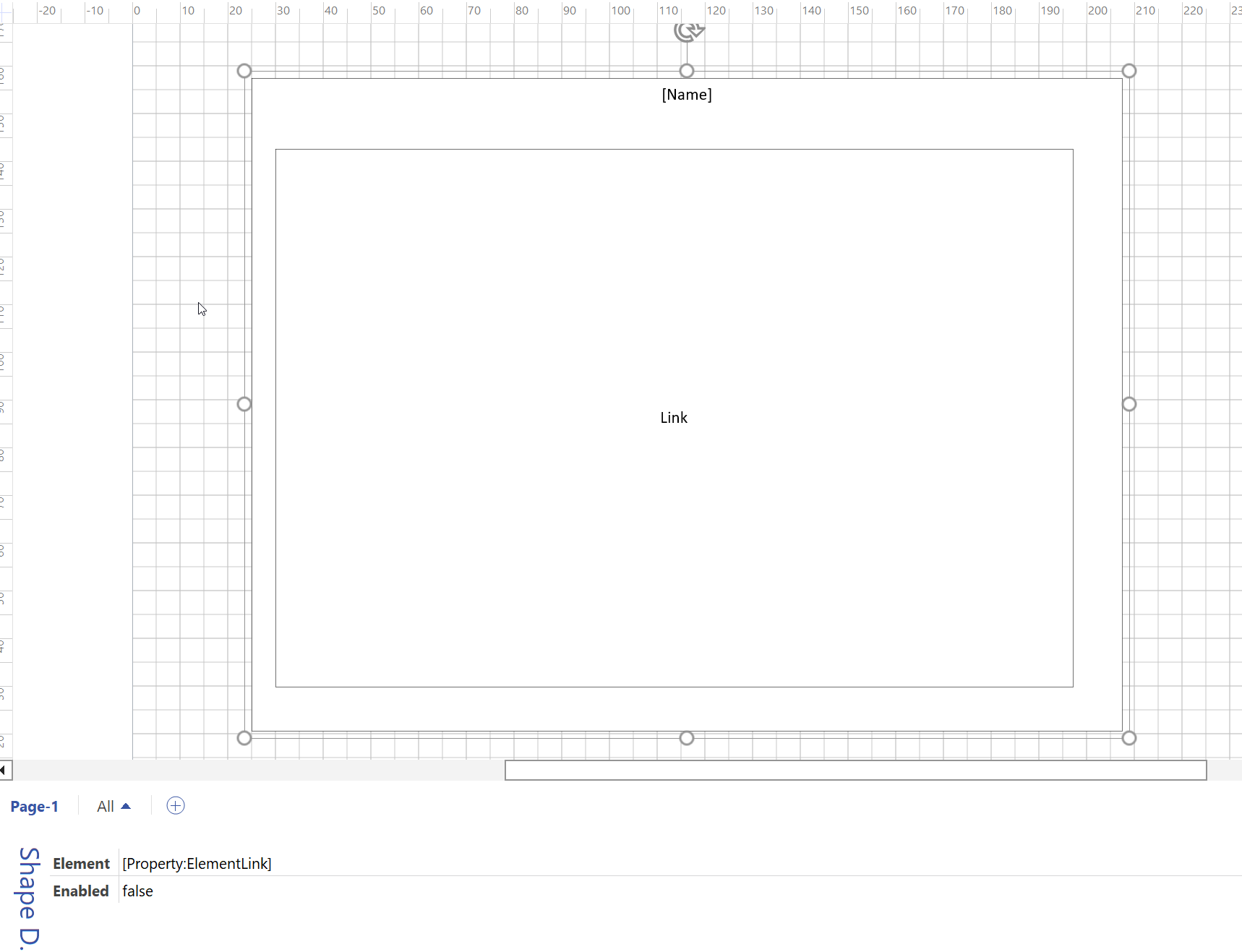

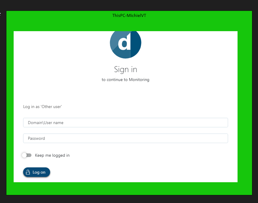

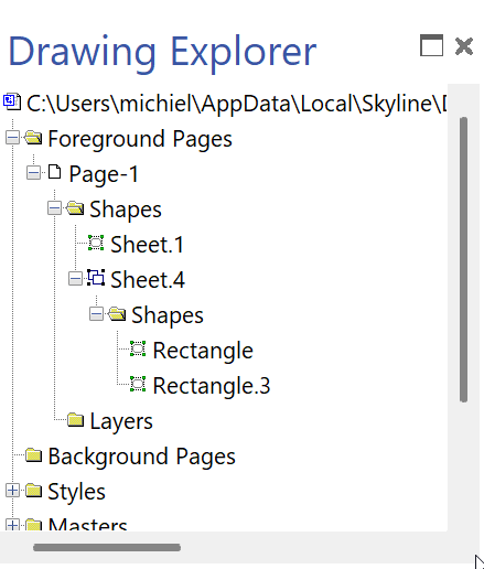

The <ElementIP> works when used in a link shape data within an element context. You can get this to work by creating a group linked to the element, and in that group, create a "link" shape that uses the <ElementIP> placeholder. I've attached some screenshots of a setup using the DMA IP from a Microsoft platform element and embedding the monitoring page to show the principle:
- Link shape using ElementIP:
- Group linked to the Element using the property placeholder
- Structure of the shapes: "Sheet.4" is the group with the "Element" shape data, "Rectangle.3" has the "Link" shape data
The result:

Michiel,
I was already close at the solution. But also with your solution I had to do an adjustment. For the outer shape enabled=false and for the inner shape enabled=false so the link if you click is working.
