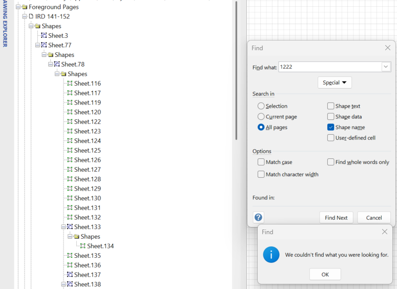

In a Visio file, I get a loading indicator for some shapes that can not be loaded. I would like to know which shapes these are.
When I close the loading indicator, I get a debug log in the cube logging indicating shape IDs like this:
Message : Visual Overview Page Loading - . Page name: IRD 141-152. Page has pending placeholders = False.
Shapes with pending placeholders: .
Loading Shapes: Duplicated shape with id: 1222;Duplicated shape with id: 931;Duplicated shape with id: 1643;Duplicated shape with id: 1654;Duplicated shape with id: 934;Duplicated shape with id: 1655;Duplicated shape with id: 1006;Duplicated shape with id: 1219;Duplicated shape with id: 935;Duplicated shape with id: 1220;Duplicated shape with id: 932;Duplicated shape with id: 1223;Duplicated shape with id: 1004;Duplicated shape with id: 1211;Duplicated shape with id: 923;Duplicated shape with id: 1651;Duplicated shape with id: 1212;Duplicated shape with id: 996;Duplicated shape with id: 1644;Duplicated shape with id: 1652;Duplicated shape with id: 1007;Duplicated shape with id: 924;Duplicated shape with id: 1003;Duplicated shape with id: 995.
But when I look in the Drawing Explorer or search in the Visio for shape IDs mentioned here, there are no results.
I suspect this to be caused by dynamically generated shapes, is this correct and is there any way to find the original shape that is causing these loading issues?
Matthijs Favorel [SLC] [DevOps Advocate] Selected answer as best 23rd October 2025
Sebastiaan Dumoulein [SLC] [DevOps Enabler]14.58K Posted 23rd October 2025 0 Comments
Hi Matthijs,
You are correct. These are newly generated IDs as they're duplicate shapes that are spawned from a master shape.
There is no way to find the loading shape through the logging in the case. Instead, you'll need to duplicate the page and start trimming shapes from it until you no longer see the loading indication.
