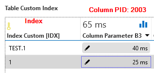

Hi Mark,
I see that you are using '1' as index to point to a specific row. Can you double check that '1' is actually the index of the table?

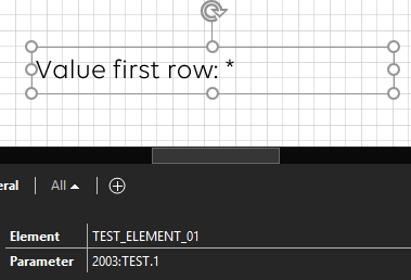

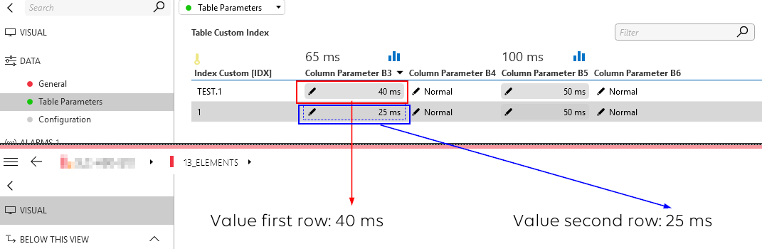

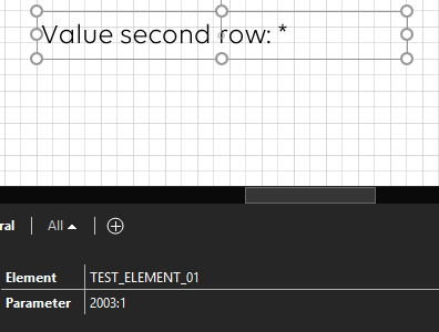

Please find below a small test that maps cell values on a shape. In this case I would like to map the values from the column 'Column Parameter B3':
In order to map these two values, I have to proceed as follows:
First row
Second row:
This will result in the following overview:
