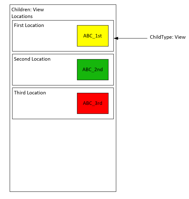

Hi Community,
given is the following view structure as an example:
>Locations
>>First Location
>>>ABC_1st
>>Second Location
>>>ABC_2nd
>>Third Location
>>>ABC_3rd
I have already have a children container successfully displaying 3 shapes dynamically for the 3 Locations of the example.
The subview values e.g. "1st" are part of a property of the Location View (e.g. "First Location" has the property "Short Name" with value "1st").
Now I would like to place another shape inside the child shape, referring to the "ABC_" subview.
How can I do this?
I already tried e.g. "View" with value "ABC_[property:Short Name]" but it doesn't work.

Felix Wesemeier [DevOps Catalyst] commented 16th April 2026
Hi Jarno,
I think this is what I already did.
Maybe something else is wrong:
>Childen-Container Group:
>View: Locations
>Children: View
>ChildrenPanel: …
>ChildrenSort: …
>>Child-Shape Group:
>>ChildType: View
>>Property: Short Name (to display the short name instead of the views name)
>>>Subshape for ABC_ View
>>>View: ABC_[property:Short Name]
>>>Options: ForcePropertyFromParent
>>>Info: View Name
For me this results in displaying and linking the subshape to the view of the parent (First Location) instead to the subview (ABC_1st).
Any idea what I did wrong?
