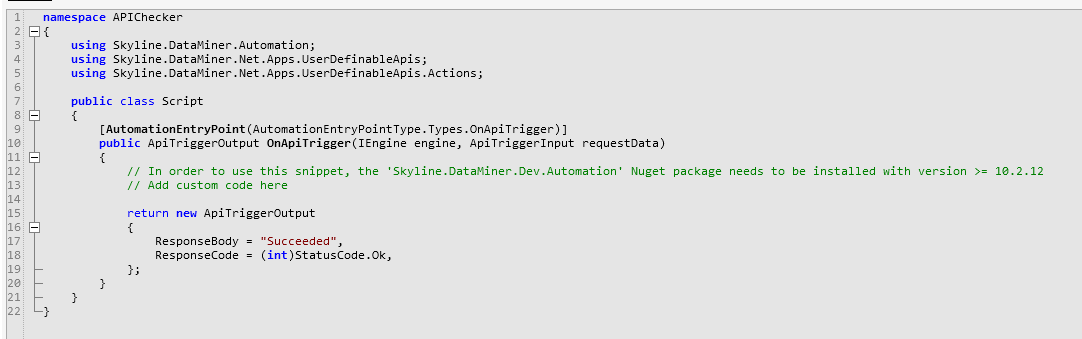

I have a simple user defined API, that throws these errors when I call it.
Any ideas what the problem could be ?
SLUserDefinableAPiManager logs:
2025/05/15 18:27:47.954|SLNet.exe|SendExecuteScriptEntryPointMessage|ERR|0|307|The executed automation script action using script 'APIChecker' did not return a valid ApiTriggerOutput.

Hi Wale,

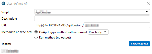

The script looks fine. Could you check the settings of the user-defined API and ensure that the "run method (no output)" option is NOT selected?
Hope this helps!
Wale Oguntoyinbo [SLC] [DevOps Advocate] Posted new comment 16th May 2025
Wale Oguntoyinbo [SLC] [DevOps Advocate] commented 16th May 2025
Hi Flavio, my current settings are as you have shown but still getting the error.
