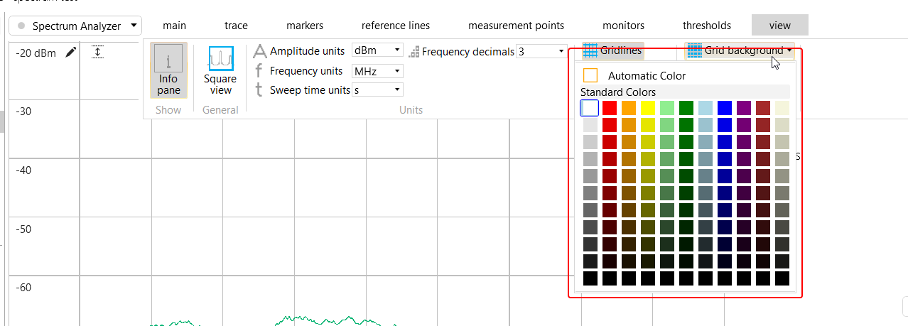

Hello,
I would like to know if it is possible to set a custom background color for the Spectrum Analyzer grid, other than the standard colors. None of the standard options match my LCA, where the Spectrum widget uses this background.

Hi Maria,
You can achieve this by sending a custom message to create the preset from automation. You can find more information in the response to this dojo question: Create Monitors and Presets with an Automation Script - DataMiner Dojo
