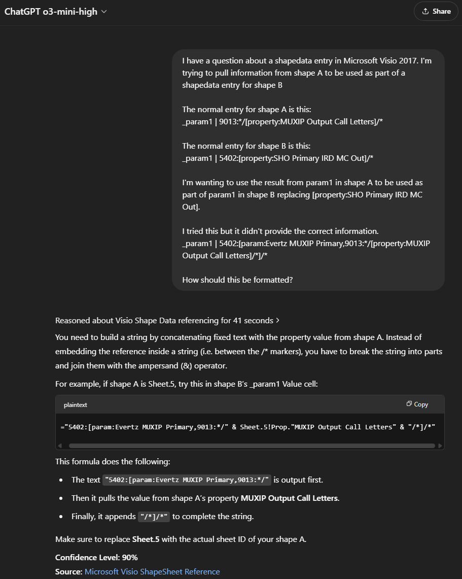

I ended up using ChatGPT o3-mini-high to figure out the formatting. Here is the resulting param string and the information that I had submitted to ChatGPT.
“5402:[param:Evertz MUXIP Primary,9013:*/” & Sheet.656!Prop.”MUXIP Output Call Letters” & “/*]/*”
This did give an exception in Visio but when asked, ChatGPT said that “If the displayed value is correct and stable, the error might just be cosmetic”. I tried some of the workarounds suggested but still haven’t found a way to get around the error. So far it appears to not affect anything as the proper data is being displayed.
