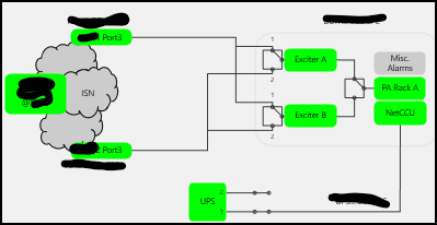

I would really appreciate your guidance on how to update an element’s colour based on alarm severity.
For example, Critical alarm is triggered for Exciter A  and i would expect the corresponding box to change to red. but in my current setup, the box remains unchanged even though I can see the active alarm in the Alarm Console.
We have a parent view where the overall site correctly appears in red. When I click the site box, it opens the detailed visual. However, in the detailed visual the affected element does not change colour, so it is difficult to identify which element has the problem.
Could you please advise what configuration or settings I need to check to make the element colour update automatically based on the active alarm severity?

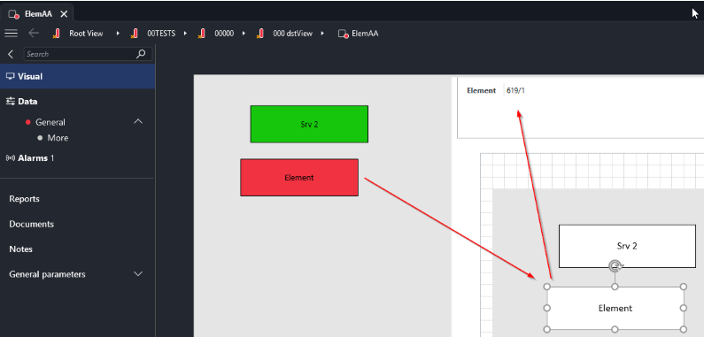

In the example below, the "Element" shape (highlighted in red) reflects a critical alarm currently open on the linked element. You can also see how the shape data is configured in this case:
I hope this helps you move forward.
