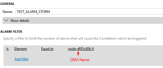

I made a quick test, and indeed, it seems that there is no information event raised when there is an alarm storm. However, the alarm raised when there is an alarm storm is linked to an element with the DMA name.
So far, the only way I could trigger the correlation rule is using this element name as alarm filter.
Since multiple alarms could be linked to this element (and not necessarily related to an alarm storm), you will need to implement additional filtering in the automation script. You can receive information from the alarm that triggered the correlation rule using this method: How do I parse Correlation Alarm Info data?

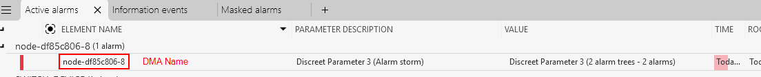

Miguel Obregon [SLC] [DevOps Catalyst] commented 14th May 2025
Hi Alexis,
These elements are available by default. However, keep in mind that they are hidden (not available in the surveyor). In order to reproduce the alarm storm, I tweaked the alarm storm setting so an alarm storm can be raised with a small number of alarms (similar to the actions executed in the video that you included in your comment). You could perform the same test to confirm the element name.

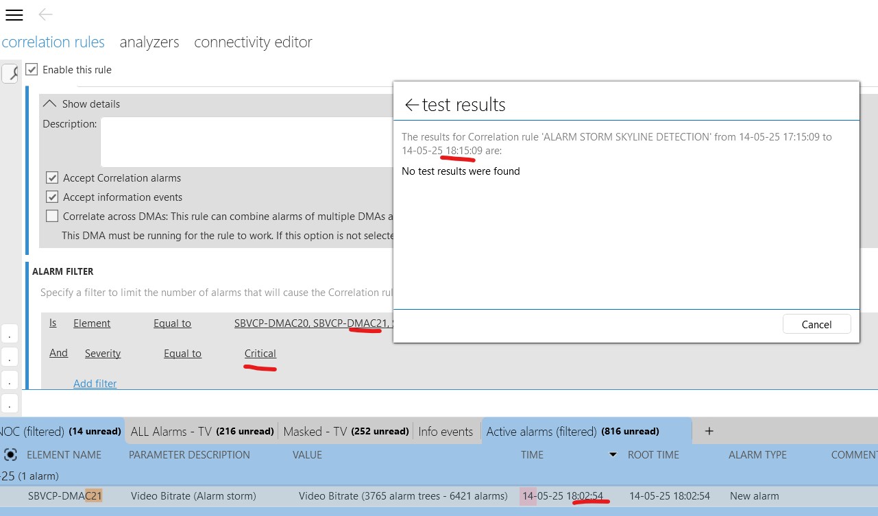

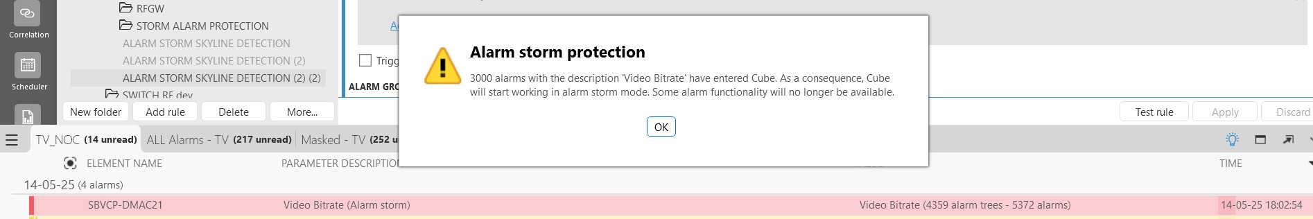

Alexis Hermant commented 14th May 2025
Some news,
In fact we have two cases:
-if alarm storm prevention from alarm with same parameter => alarm grouping
In this case I have an alarm "Video Bitrate (Alarm storm)", but can't trigger a coorelation with this (why??)
-if alarm storm prevention from amount of alarms on a period => alarms delayed (it's the case I work on)
In this case I have no alarm to trigger the correlation
(find below a screenshot to show exactly what happens)
