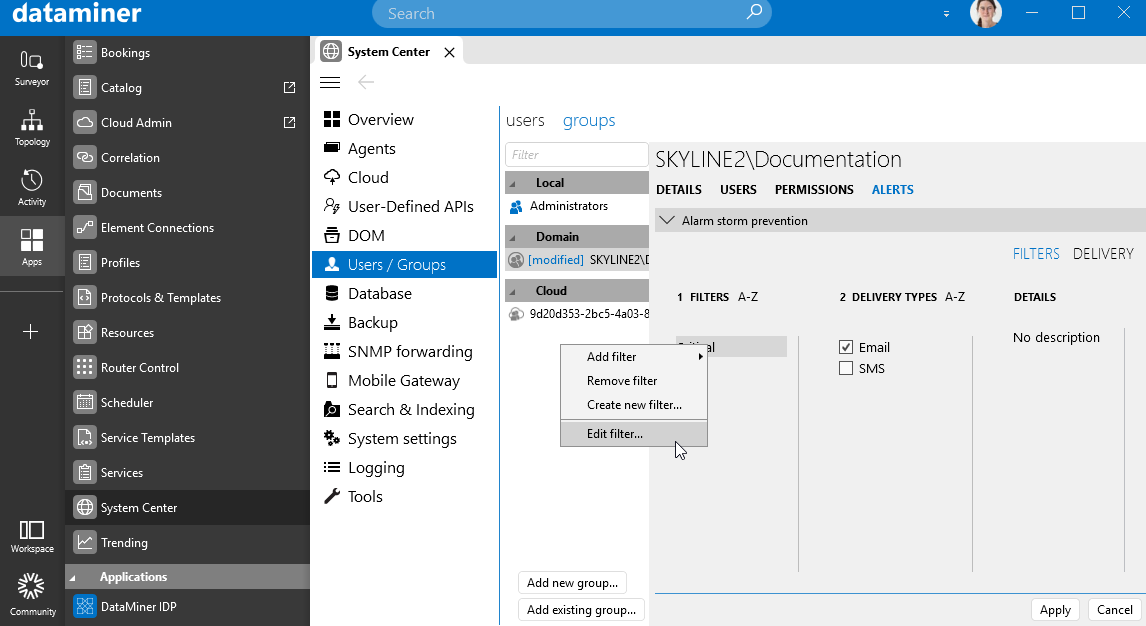

Hi Roshan,
This depends on how the alerts have been configured. Usually this is done in the Users / Groups module in System Center (in DataMiner Cube), via the Alerts tab. It can be configured on group level, or on user level, or both. Could you check if you can find an alarm filter there that you can fine-tune in order to change which alerts you receive?
You can also find more information on how to configure notifications here: Configuring user notifications | DataMiner Docs
