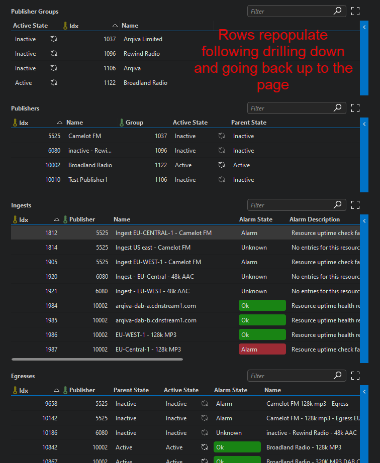

I am having an issue with an element popup page. I am using a Tree Control but i still want to expose the the raw tables in the element UI.

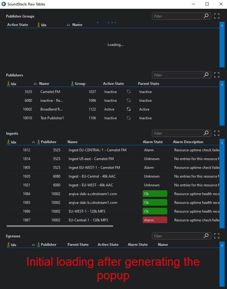

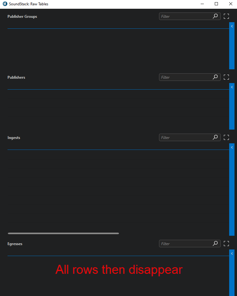

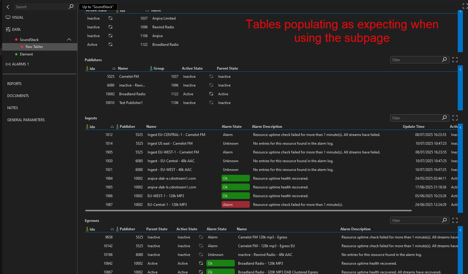

If i navigate to the subpage then the raw tables populate as expected. However if i use the popup button to display the page as a popup the some of table rows initially load but then disappear. If I drill down onto one of the table parameters and select to go back to the pop up page the all tables are fully populated.
I can also confirm that the tables are also displayed correctly in the tree control. Do you know what might be causing this behavior?
