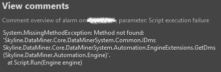

The script "Validate" in Cube shows “No errors”, but when I execute it I get the following error:
System.MissingMethodException: Method not found:
'Skyline.DataMiner.Core.DataMinerSystem.Common.IDms
Skyline.DataMiner.Core.DataMinerSystem.Automation.EngineExtensions.GetDms
(Skyline.DataMiner.Automation.Engine)'
at Script.Run(Engine engine)

On 10.4.0 this worked without any issues. The error only started appearing after the upgrade to 10.5.0-16515.
