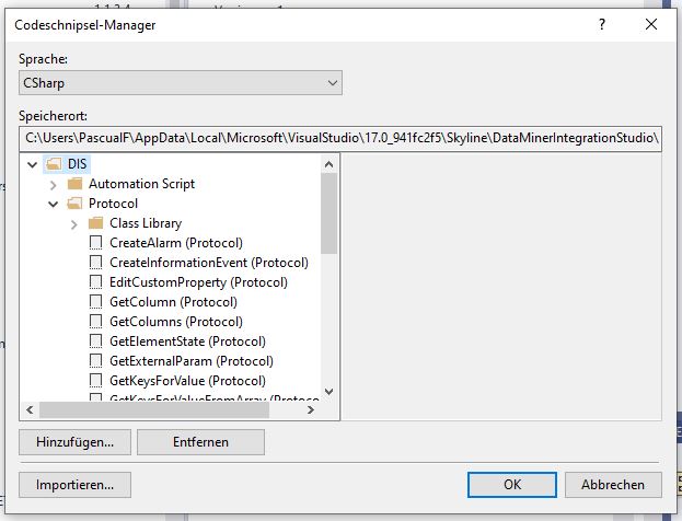

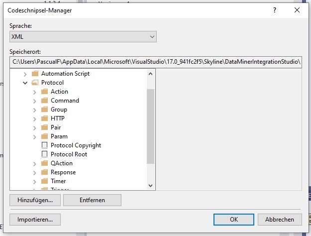

Francisco Javier Pascual [DevOps Member]79 Posted 14th August 2025 1 Comment
Hi Thomas,
For the XML language, I think they're all there, but for the C# language, I suspect some aren't loading correctly. I've tested with both XML and C# files, and for neither, the snippet appears in the context menu. Calling snippets using the shortcut ctrl+k, ctrl+x works properly. Although for C# files not all snippets are available.

Thomas Cauwelier [SLC] [DevOps Advocate] commented 15th December 2025
Hi Francisco,
Sorry for the delayed follow-up. It looks like I didn’t receive a notification for your reply.
Are you still experiencing this issue with snippets?
From your screenshots, Visual Studio appears to recognize the snippets correctly. It seems like the problem is specifically with the Insert Snippet context menu.
For C# files, you mentioned that not all snippets are available when using the shortcut. Could you let me know which specific C# snippets are missing, or share a screenshot or list for comparison? That could help me determine cause of the issue.

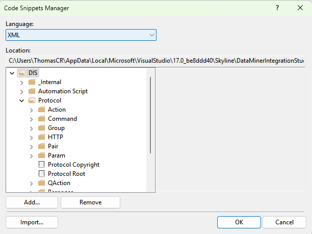

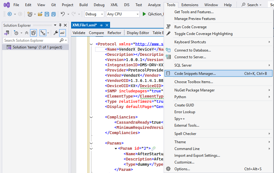

Thomas Cauwelier [SLC] [DevOps Advocate]1.87K Posted 14th August 2025 0 Comments
Hi Francisco,
Could you check if you can open the snippets menu via the default Ctrl+k, Ctrl+x shortcut? Note: the snippets will only appear when editing cs or xml files.
Do the snippets appear in the Code Snippets Manager?
