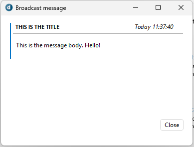

If you however would just like to show a pop-up message, you can use the 'BroadCastPopupRequestMessage' SLNet message. With this, you can have a popup-up that can be configured with a title, message and recipients (empty if it should pop up for everyone). More info can be found here: https://docs.dataminer.services/release-notes/General/General_Main_Release_10.0/General_Main_Release_10.0.0_new_features_2.html#all-cube-clients-will-now-display-broadcast-popups-sent-from-qactions-automation-scripts-etc-id-21733id-21928id-22089

Thanks, Thomas — that was exactly the idea, and the popup worked perfectly. Appreciate the help!
