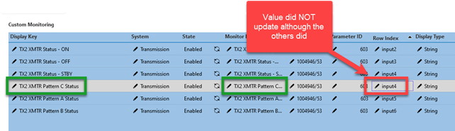

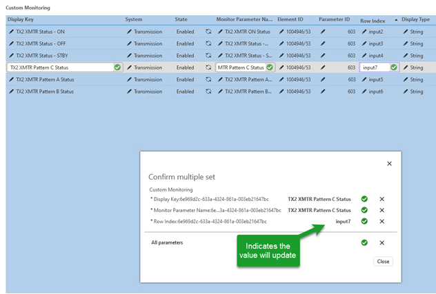

Users are allowed to change the display keys on two tables, which launches a QAction that verifies that the new display key is valid before setting it. When a user tries to change multiple values in a row while also changing the display key, we find that sometimes all the sets succeed, and everything is updated and sometimes some of the changes other than the display key fail and retain their value. I'll attach some images of the issue to the original post.
