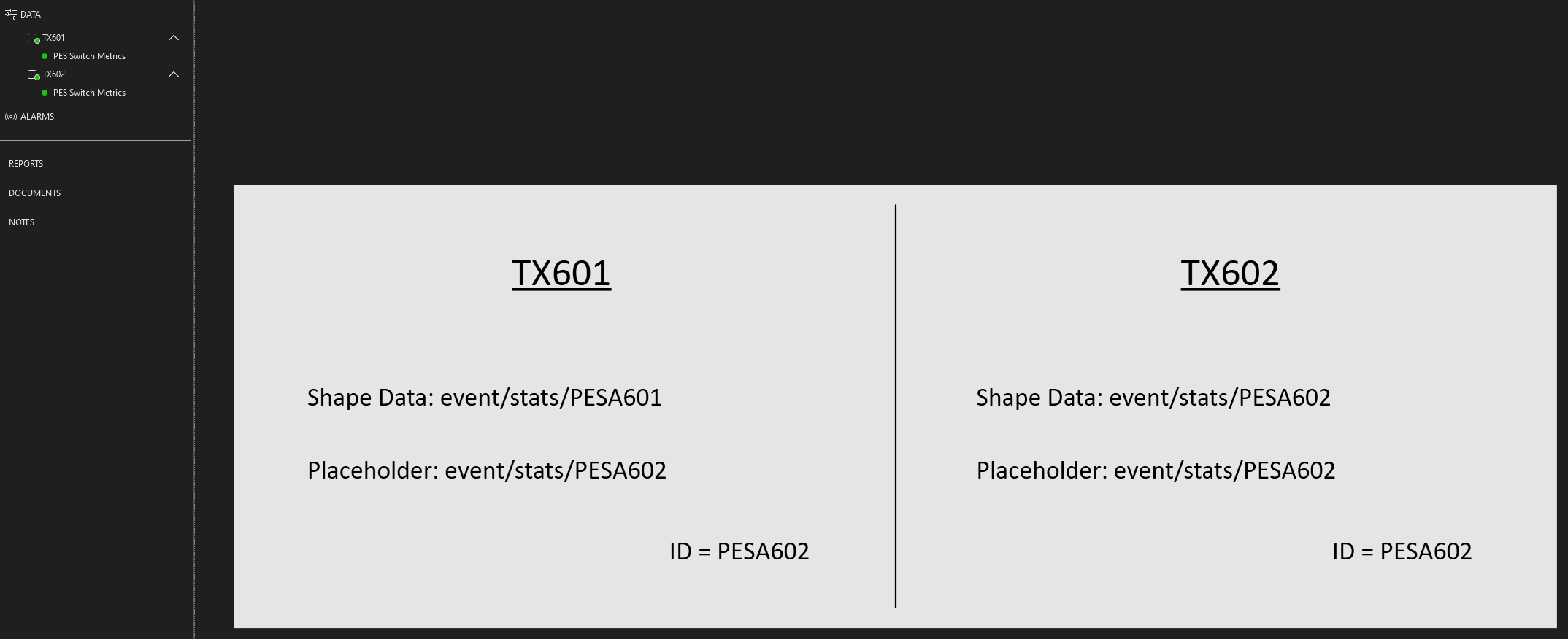

  • Note that the first 2 shapes will display the value of the last child element for BOTH child aliases, whereas the last shape will display unique values cooresponding to the child alias used.

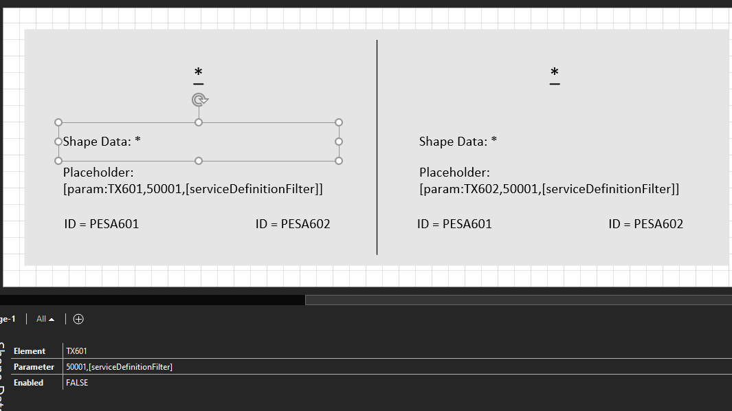

Here is my Visio w/ the 'Shape Data: *' shape data visible.
Note that the ID = PESA601 shape data is:
  • SHOW: <A>-A|Element:TX601|Parameter:50001,[serviceDefinitionFilter]|=event/stats/PESA601

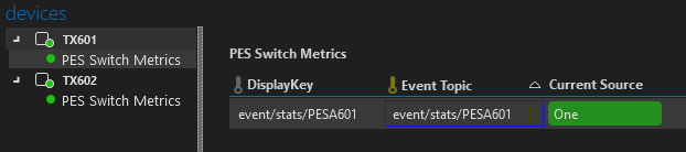

Here is how it looks in Cube:

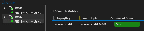

Here is the table data from the service (Note both TX601 & TX602 share the same underlying element):

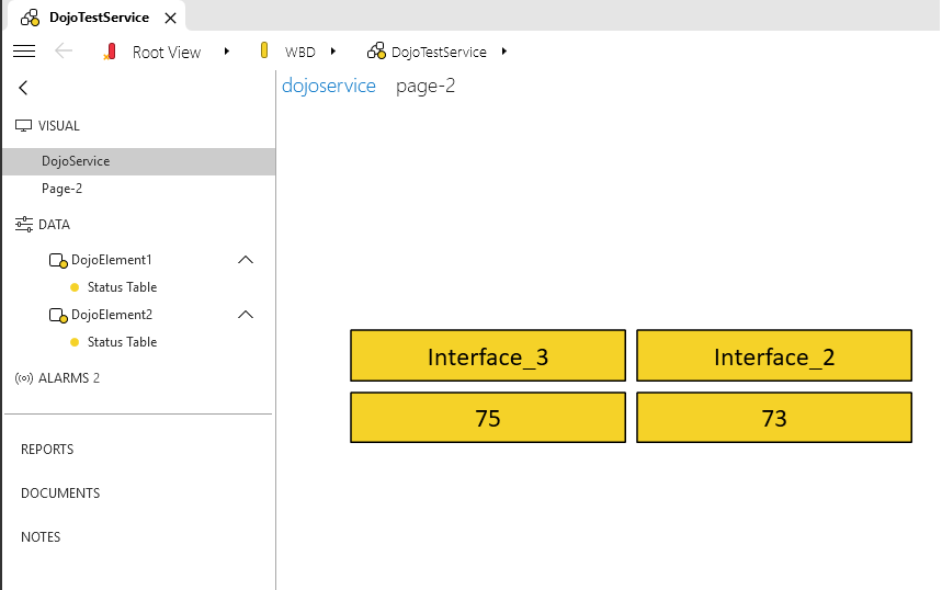

Want to start off with nice write up, I was able to configure and test easily.
In my testing the system worked as you expected both services showed the correct corresponding data.

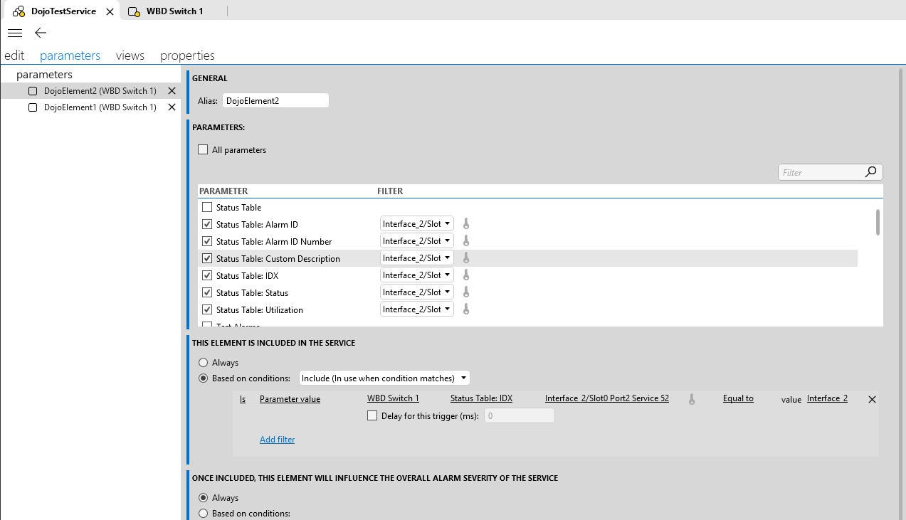

The only question I have, is when creating the service, did you select the Table Name or the individual parameters filtered to desired IDX?

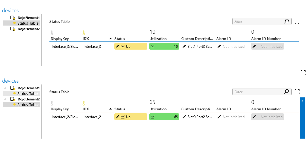

Following is how my service was setup using the parameter selection with IDX selected not the entire table option:

I did select the individual parameters with a filter for each child element, like you have in your screenshot.
To confirm, are those parameters you've displayed using the [param:element,id,index] placeholder or just the Parameter shape data? This works for me using the latter but not the former.
Steve Purcell [SLC] [DevOps Advocate] commented 19th May 2025
Hi Nick, Correct, my example was working with the parameter shape data field not the shape text. In order to function using the [param:] lookup in the shape text, I had to use the actual filter data IDX value in place of the [servicedefinitionfilter] lookup. This appears to be due to the multiple service Alias references pointing to the same physical element, so the first servicefilter reference is being returned for both Alias entries in the shape text. When replacing the [servicedefinitionfilter] reference with the physical IDX value of the desired row, the shape text then populated as desired.
