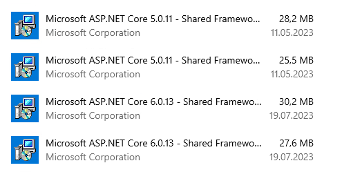

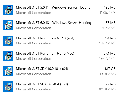

Customer is running DataMiner Version 10.5.0.0-16643  (10.5 CU10).  Following a security vulnerability  assessment they are asked to uninstall and remove older SW from the DMA servers specifically referring to the following SW packages:
According to the SW requirements on
DataMiner Compute Requirements | DataMiner Docs
for version 10.5 CU10 the following is required:
  • Microsoft .NET Framework 4.8
  • .NET 8.0
  • .NET 10.0
But can you indicate for each of the SW packages in above screenshot if they can be safely uninstalled without affecting DataMiner?

Hi Koen,
All the packages with versions 5.0.11 and 6.0.13 in their name can be safely uninstalled from the Agent.
