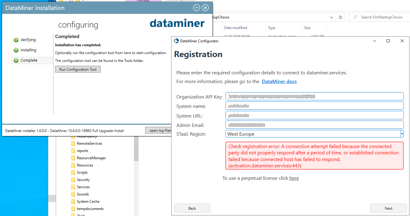

Hi all,
We are currently trying to register an on-prem DMA with DataMiner Services after installation, among other things to enable STaaS.
One special aspect of this setup is that the registration must be performed through a proxy server (without authentication).
There is an organization with a valid API key and a registered admin email address, and as far as we know, all prerequisites have been met. For example:
Firewall rules have been configured according to the documentation:
  • https://docs.dataminer.services/dataminer/Administrator_guide/Security/About_DMS_Security/Cloud_connectivity_and_security.html#connecting-to-dataminerservices
  • The proxy server has been configured in C:\ProgramData\Skyline Communications\DxMs Shared\appsettings.proxy.json
  • Other known prerequisites have been checked as well
However, the registration of DataMiner Services and STaaS during installation fails with the following error message:
The output of ConnectionTester.exe shows mostly successful checks, except for a few BadRequest entries at the beginning. We are not sure whether these are expected or if they indicate a problem:
[2026-07-16 16:57:40.736 INF]Starting web host[] [2026-07-16 16:57:41.361 INF]Running version 2.17.14.0+16d285a500d2eaea489202f85c604cd200d63082 at C:\Program Files\Skyline Communications\DataMiner CloudGateway\DataMiner CloudGateway.exe[SLCcaGatewayService.Services.GeneralServices.Impl.GatewayVersionProvider] [2026-07-16 16:57:41.386 INF]Using proxy for all outgoing internet access: <proxy-address><proxy-port>[SLCcaGatewayService.Services.GeneralServices.Impl.HttpClientProvider] [2026-07-16 16:57:41.761 INF]Created the message broker[MessageBrokerWrapper.MessageBrokerWrapper] [2026-07-16 16:57:41.792 INF]Checking connection to endpoints[ConnectionTester.Services.Impl.EndpointConnectionTester] [2026-07-16 16:57:41.795 INF]Checking connection to Api endpoints...[ConnectionTester.Services.Impl.EndpointConnectionTester] [2026-07-16 16:57:41.882 WRN]Did not receive the expected result. Expected: Unauthorized, Actual: BadRequest[ConnectionTester.Services.Impl.EndpointConnectionTester] [2026-07-16 16:57:41.886 INF]Checking Uri: https://api.dataminer.services/api/dms-auth/v1-0/dms-identity/me/credentials, State: WARNING[ConnectionTester.Services.Impl.EndpointConnectionTester] [2026-07-16 16:57:41.909 WRN]Did not receive the expected result. Expected: BadRequest, Actual: UnsupportedMediaType[ConnectionTester.Services.Impl.EndpointConnectionTester] [2026-07-16 16:57:41.911 INF]Checking Uri: https://api.dataminer.services/api/dms-auth/v1-0/dms-identity/me/token, State: WARNING[ConnectionTester.Services.Impl.EndpointConnectionTester] [2026-07-16 16:57:41.938 WRN]Did not receive the expected result. Expected: BadRequest, Actual: Unauthorized[ConnectionTester.Services.Impl.EndpointConnectionTester] [2026-07-16 16:57:41.940 INF]Checking Uri: https://api.dataminer.services/api/dms-events/v1-0/ingest, State: WARNING[ConnectionTester.Services.Impl.EndpointConnectionTester] [2026-07-16 16:57:42.085 INF]Connection to Api endpoints, State: OK[ConnectionTester.Services.Impl.EndpointConnectionTester] [2026-07-16 16:57:42.087 INF]Checking connection to Connect endpoints...[ConnectionTester.Services.Impl.EndpointConnectionTester] [2026-07-16 16:57:42.340 INF]Connection to Connect endpoints, State: OK[ConnectionTester.Services.Impl.EndpointConnectionTester] [2026-07-16 16:57:42.342 INF]Checking connection to Preview feature: global.dataminer.services endpoints...[ConnectionTester.Services.Impl.EndpointConnectionTester] [2026-07-16 16:57:42.811 INF]Connection to Preview feature: global.dataminer.services endpoints, State: OK[ConnectionTester.Services.Impl.EndpointConnectionTester] [2026-07-16 16:57:42.814 INF]Checking connection to Artifacts Storage endpoints...[ConnectionTester.Services.Impl.EndpointConnectionTester] [2026-07-16 16:57:42.964 INF]Connection to Artifacts Storage endpoints, State: OK[ConnectionTester.Services.Impl.EndpointConnectionTester] [2026-07-16 16:57:42.966 INF]Checking connection to Artifacts Events endpoints...[ConnectionTester.Services.Impl.EndpointConnectionTester] [2026-07-16 16:57:43.910 INF]Connection to Artifacts Events endpoints, State: OK[ConnectionTester.Services.Impl.EndpointConnectionTester] [2026-07-16 16:57:43.913 INF]Checking connection to Data Collection endpoints...[ConnectionTester.Services.Impl.EndpointConnectionTester] [2026-07-16 16:57:44.076 INF]Connection to Data Collection endpoints, State: OK[ConnectionTester.Services.Impl.EndpointConnectionTester] [2026-07-16 16:57:44.078 INF]Checking connection to Cloud Feed Events endpoints...[ConnectionTester.Services.Impl.EndpointConnectionTester] [2026-07-16 16:57:45.061 INF]Connection to Cloud Feed Events endpoints, State: OK[ConnectionTester.Services.Impl.EndpointConnectionTester] [2026-07-16 16:57:45.064 INF]Connection to endpoints, State: OK[ConnectionTester.Services.Impl.EndpointConnectionTester][2026-07-16 16:57:45.317 INF]Connection to IP's, State: OK[ConnectionTester.Services.Impl.IpConnectionTester] [2026-07-16 16:57:45.335 INF]Checking web socket connection to tunnel[ConnectionTester.Services.Impl.WebSocketTester] [2026-07-16 16:57:45.439 INF]Web socket connection to tunnel, State: OK[ConnectionTester.Services.Impl.WebSocketTester] [2026-07-16 16:57:45.462 INF]Checking NATS by discovering other DataMiner CloudGateways in the DMS[ConnectionTester.Services.Impl.EndpointConnectionTester] [2026-07-16 16:57:45.488 INF]Discovered DataMiner CloudGateway with internet access at http://10.87.10.44:5100[ConnectionTester.Services.Impl.EndpointConnectionTester] [2026-07-16 16:57:45.647 INF]Discovered 1 DataMiner CloudGateways with internet access in total.[ConnectionTester.Services.Impl.EndpointConnectionTester] [2026-07-16 16:57:45.650 INF]Checking DataMiner CloudGateways Proxy Endpoints[ConnectionTester.Services.Impl.EndpointConnectionTester] [2026-07-16 16:57:45.653 INF]Validating DataMiner CloudGateway with internet access at http://10.87.10.44:5100[ConnectionTester.Services.Impl.EndpointConnectionTester] [2026-07-16 16:57:45.742 INF]Validating succeeded for DataMiner CloudGateway with internet access at http://10.87.10.44:5100[ConnectionTester.Services.Impl.EndpointConnectionTester] [2026-07-16 16:57:45.745 INF]Validation succeeded for 1 DataMiner CloudGateways with internet access in total.[ConnectionTester.Services.Impl.EndpointConnectionTester] [2026-07-16 16:57:45.747 INF]Connection to NATS & DataMiner CloudGateways Proxy Endpoints, State: OK[ConnectionTester.Services.Impl.EndpointConnectionTester] [2026-07-16 16:57:45.749 INF]--------------------------------------------------------------------------------[ConnectionTester.Services.Impl.TestRunner] [2026-07-16 16:57:45.752 INF]Connection, State: WARNING, Warnings: 3[ConnectionTester.Services.Impl.TestRunner] [2026-07-16 16:57:45.753 INF]Endpoint check, Warnings: 3[ConnectionTester.Services.Impl.TestRunner] [2026-07-16 16:57:45.755 INF]Check the logging above to see what went wrong[ConnectionTester.Services.Impl.TestRunner] [2026-07-16 16:57:45.757 INF]Done[ConnectionTester.Services.Impl.TestRunner]
Is there anything we might have overlooked? Are there any suggestions, troubleshooting tips, or ideas on how to resolve this issue?
Thanks!

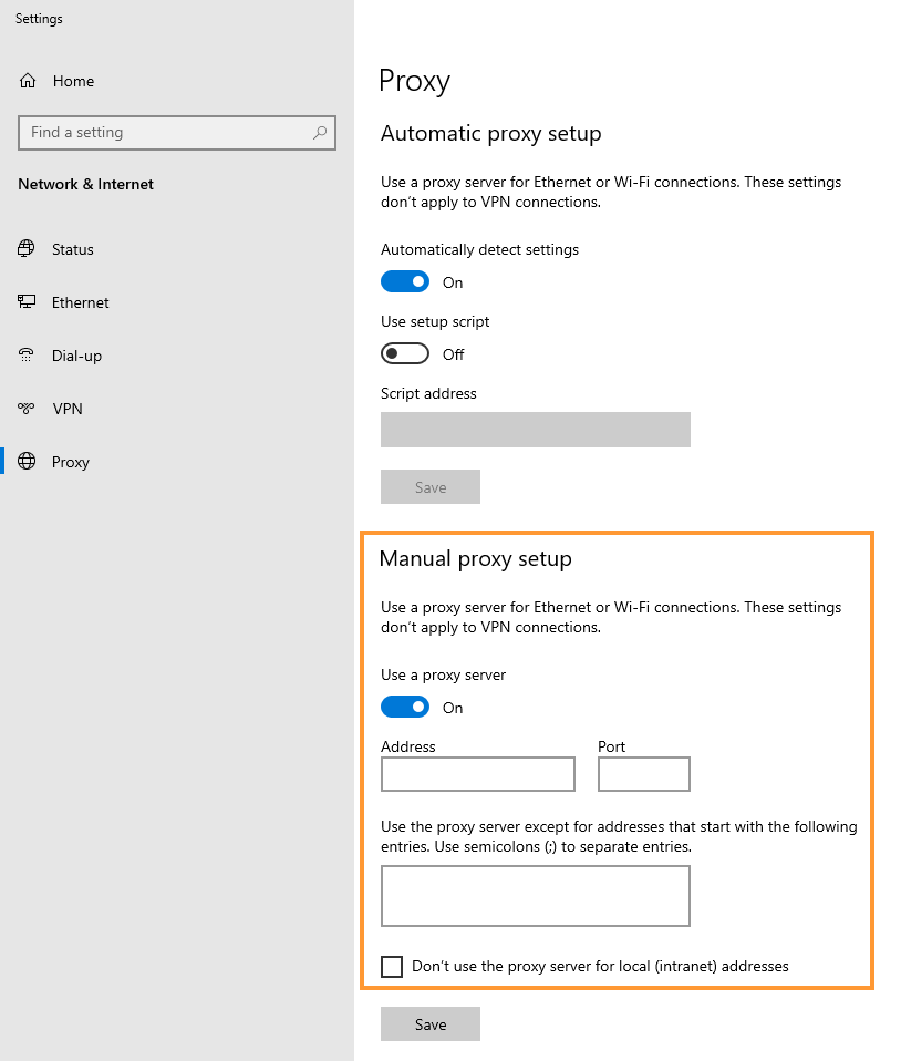

Hi Jörg, unfortunately the configurator is an independent tool and doesn't use any of the proxy information you configured for the DxMs. Could you try configuring the proxy on server level?
Jörg Knesebeck [DevOps Enabler] Selected answer as best 17th July 2026
Jörg Knesebeck [DevOps Enabler] commented 17th July 2026
Hi Wouter, many thanks for the suggestion, actually it helped! Setting the proxy here enabled the Configuration Process to proceed. I thought setting the proxy on that level won't help because it's then related to my Windows user account (rather than SYSTEM user), but that assumption was obviously wrong. So we are going further now, thanks.
