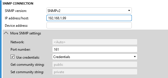

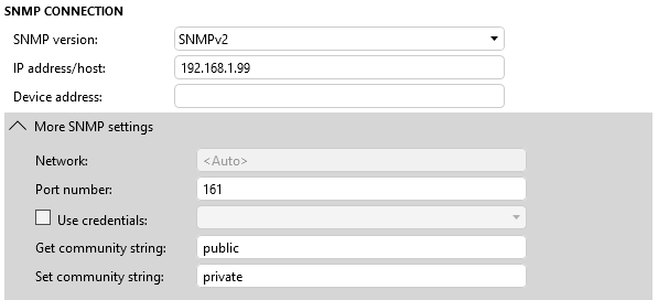

However the problem is that if the element is using an entry from the credentials library for say the SNMP community strings rather than having them specified directly, then once the element has been updated, the credentials selection is unticked.
Before running the script the element settings look as follows:
But after the script completes, the element settings look as follows:
As a result the element then goes into timeout and I have to manually use Cube to reselect the credentials and apply it, which rather defeats the purpose of writing a script to copy elements into a view.
