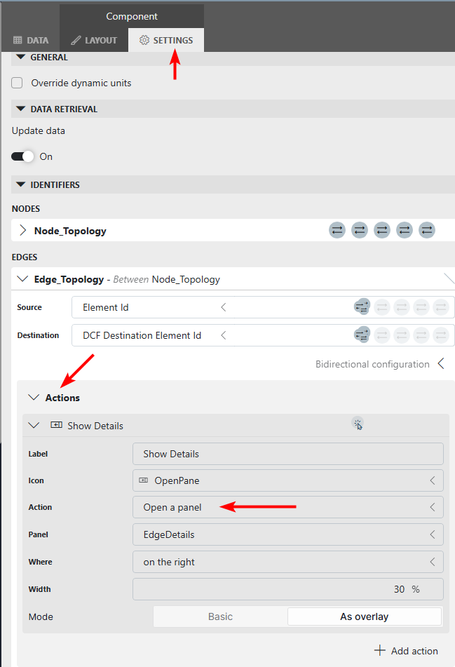

Ive Herreman [SLC] [DevOps Enabler]14.80K Posted 1st July 2025 1 Comment
Hi Juan,
Yes, this is possible using these steps
1. Create a new panel with your trend graph.
2. Linking the parameters to your trend graph based on protocol. (Don't add any elements or indices yet).
3. Return to your page with the node edge-component.
4. Make sure you select an edge on your node-edge.
5. Edit the panel containing your trend graph from steps 1 & 2.

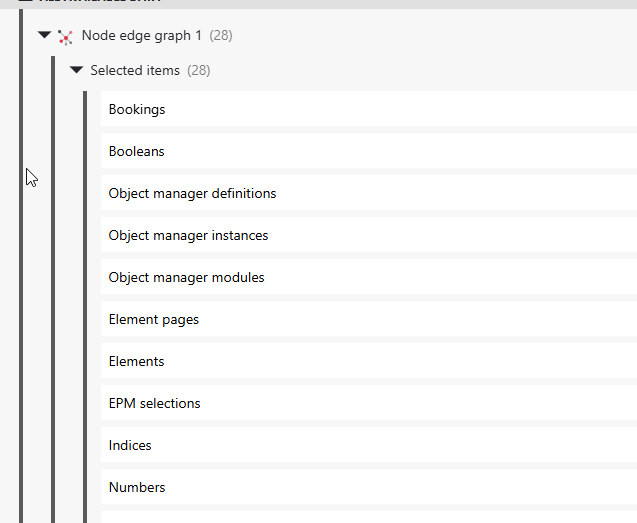

6. From the data section on the right, under components, find your node edge and select the relevant feeds (elements and or indices) and drag these onto your trend graph as a filter.
7. Return to your node-edge.
8. Add an action to the edge of your node-edge diagram to open the panel.

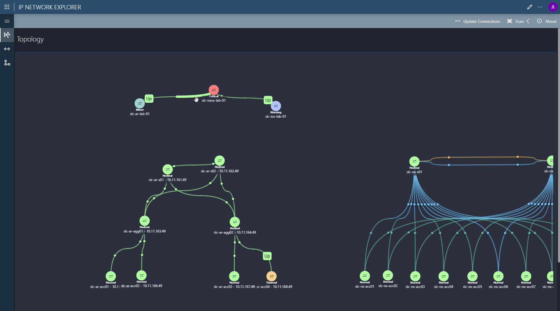

The result could then look something like this:
