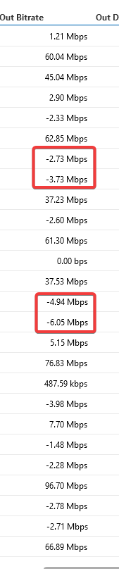

We are working implementing the new rate calculation methods in an old connector (NuGet Gallery | Skyline.DataMiner.Utils.Rates.Protocol 1.0.0.5), but for some reason we are getting some negative rate results:
We suspect that this is due to wraparounds that normally happen when counters reach the maximum UInt32 value in this case, as you can see in the rate data stored:
