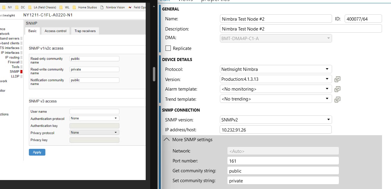

We are trying to connect into a Net Insight Nimbra frame for monitoring using the Net Insight Nimbra connector, but cannot make a successful connection.
A firewall between the DM node and the Nimbra device has a rule to allow UDP traffic on ports 161 and 162.
Attached is a screen capture showing the configuration of the Nimbra SNMP, and the DataMiner configuration.
Are there any other steps required to set this connector up?
Mike Dilworth [DevOps Member] commented 20th June 2025
For reference: We are running a Nimbra 688 chassis with firmware version GX6.3. We have version 4.1.3.13 of the connector installed.

Hi Mike,
According to the documentation it appears you have configured things correctly.
Could you check using the Stream Viewer or the element log file to see if there is any indication of an error?

João Severino [SLC] [DevOps Enabler] commented 25th June 2025
Hi Mike, given that StreamViewer is showing Timeouts and considering that what you are trying to poll are tables which in some devices can contain large amounts of data I would suggest you to increase the 'Timeout of a single command (ms)" value from the default to something larger like 5000 ms or even 10000 ms.
This should allow us to determine whether the issue is simply that it takes a bit longer to poll the device or if there is another underlying issue.
