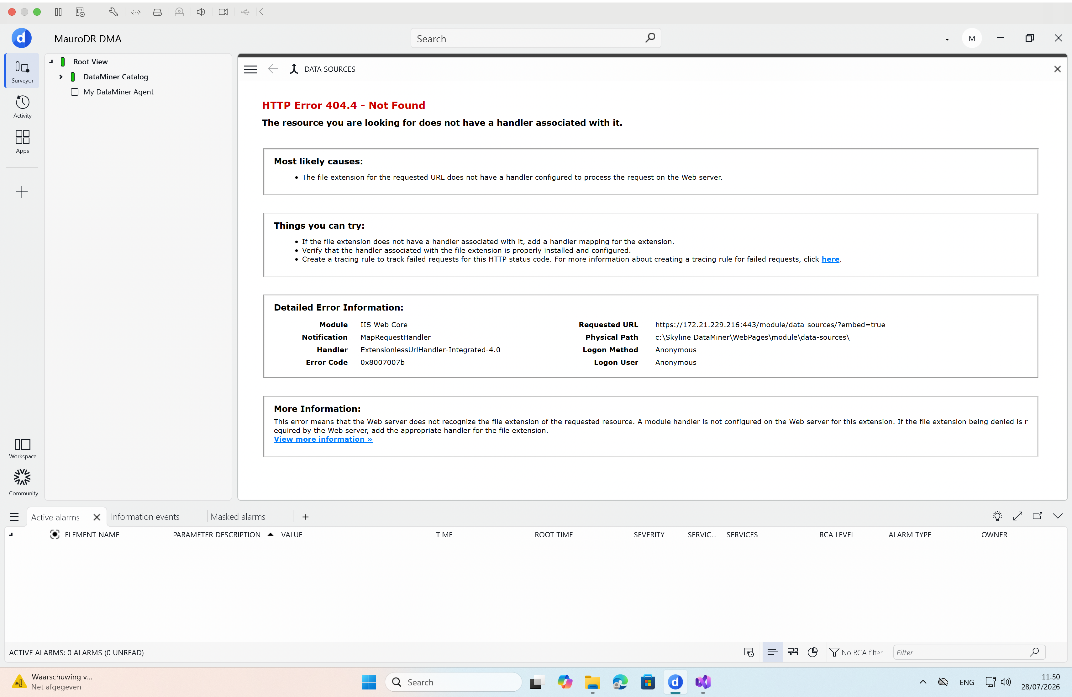

Hi community, 😊
I recently installed a fresh instance of DataMiner on this VM and upgraded it to feature release 10.6.8.0-17343. After that, I activated the soft launch option (DataAPI) and deployed two DxMs: DataAPI (v1.4.6.0) and DataAggregator (v3.2.0.7527).
However, even after a system reboot, I am still getting an Error 404 via both the Cube Data Sources tab and the web interface (see attached screenshot).
How can I resolve this? Thanks! 🙌

Hi Mauro,
At startup, DataAggregator DxM should create these files if they don't exist yet:
C:\Skyline DataMiner\WebPages\data-sources\web.config
C:\Skyline DataMiner\WebPages\module\data-sources\web.config
The first one creates a redirect and the second one configures IIS as reverse proxy:
<action type="Redirect" url="/module/data-sources/" />
<action type="Rewrite" url="http://localhost:12345/{R:0}" />
If these files/folders do not exist, check the DxM logfile for potential errors:
C:\ProgramData\Skyline Communications\DataMiner DataAggregator\Logs\SLDataAggregator.txt

Hi Bert,
Those 2 files exist (with the content) and I can also the correct redirects/rewrites via the IIS UI, so that's not the problem I suppose. I do have some errors in the logfile: [2026-07-27 17:19:37.617 INF]Starting web host[]
[2026-07-27 17:19:39.394 INF]NatsEndPointsService is setting-up 1 NATS connections.[DataAggregator.MessageBroker.NatsEndPointsService]

[2026-07-27 17:29:09.703 INF]Now listening on: http://0.0.0.0:12345%5BMicrosoft.Hosting.Lifetime%5D
[2026-07-27 17:29:09.705 INF]Application started. Press Ctrl+C to shut down.[Microsoft.Hosting.Lifetime]
[2026-07-27 17:29:09.706 INF]Hosting environment: Production[Microsoft.Hosting.Lifetime]
[2026-07-27 17:29:09.706 INF]Content root path: C:Program FilesSkyline CommunicationsDataMiner DataAggregator[Microsoft.Hosting.Lifetime]
[2026-07-27 17:29:09.718 INF]Scheduler QuartzScheduler_$_NON_CLUSTERED started.[Quartz.Core.QuartzScheduler]
[2026-07-27 17:29:38.781 INF]Received registration state from CloudGateway was true[DxmUtilities.CloudRegistrationListener.CloudRegistrationService]
[2026-07-27 17:29:38.781 INF]Will stop polling registration state from CloudGateway due to successful response[DxmUtilities.CloudRegistrationListener.CloudRegistrationService]
[2026-07-27 17:29:38.782 INF]Registered state received from CloudGateway, starting publishing of DxM status[DxmUtilities.DxmStatusReporter.DxmStatusReporterWorker]
[2026-07-27 17:29:38.782 INF]Finished polling, received response from CloudGateway with registration status[DxmUtilities.CloudRegistrationListener.CloudRegistrationService]
[2026-07-28 11:44:40.616 INF]Application is shutting down…[Microsoft.Hosting.Lifetime]
[2026-07-28 11:44:40.979 INF]DataAggregatorHandlerService is stopping[DataAggregator.HostedServices.DataAggregatorHandlerService]
[2026-07-28 11:44:41.042 INF]Scheduler QuartzScheduler_$_NON_CLUSTERED shutting down.[Quartz.Core.QuartzScheduler]
[2026-07-28 11:44:41.049 INF]Scheduler QuartzScheduler_$_NON_CLUSTERED paused.[Quartz.Core.QuartzScheduler]
[2026-07-28 11:44:41.066 INF]Scheduler QuartzScheduler_$_NON_CLUSTERED Shutdown complete.[Quartz.Core.QuartzScheduler]
[2026-07-28 11:44:41.139 INF]Cancellation requested, stopping DxmStatusReporterWorker[DxmUtilities.DxmStatusReporter.DxmStatusReporterWorker]
[2026-07-28 11:45:15.965 INF]Starting web host[]
[2026-07-28 11:45:18.401 INF]NatsEndPointsService is setting-up 1 NATS connections.[DataAggregator.MessageBroker.NatsEndPointsService]
[2026-07-28 11:45:23.944 INF]Could not create a message broker session yet… Retrying in 5 seconds…[MessageBrokerWrapper.MessageBrokerWrapper]
[2026-07-28 11:45:30.995 INF]Could not create a message broker session yet… Retrying in 5 seconds…[MessageBrokerWrapper.MessageBrokerWrapper]
[2026-07-28 11:45:38.051 INF]Could not create a message broker session yet… Retrying in 5 seconds…[MessageBrokerWrapper.MessageBrokerWrapper]
[2026-07-28 11:45:45.104 INF]Could not create a message broker session yet… Retrying in 5 seconds…[MessageBrokerWrapper.MessageBrokerWrapper]
[2026-07-28 11:45:52.163 INF]Could not create a message broker session yet… Retrying in 5 seconds…[MessageBrokerWrapper.MessageBrokerWrapper]
[2026-07-28 11:45:59.224 INF]Could not create a message broker session yet… Retrying in 5 seconds…[MessageBrokerWrapper.MessageBrokerWrapper]
[2026-07-28 11:46:06.262 INF]Could not create a message broker session yet… Retrying in 5 seconds…[MessageBrokerWrapper.MessageBrokerWrapper]
[2026-07-28 11:46:13.303 INF]Could not create a message broker session yet… Retrying in 5 seconds…[MessageBrokerWrapper.MessageBrokerWrapper]
[2026-07-28 11:46:20.329 INF]Could not create a message broker session yet… Retrying in 5 seconds…[MessageBrokerWrapper.MessageBrokerWrapper]
[2026-07-28 11:46:27.383 INF]Could not create a message broker session yet… Retrying in 5 seconds…[MessageBrokerWrapper.MessageBrokerWrapper]
[2026-07-28 11:46:34.447 INF]Could not create a message broker session yet… Retrying in 5 seconds…[MessageBrokerWrapper.MessageBrokerWrapper]
[2026-07-28 11:46:41.486 INF]Could not create a message broker session yet… Retrying in 5 seconds…[MessageBrokerWrapper.MessageBrokerWrapper]
[2026-07-28 11:46:48.544 INF]Could not create a message broker session yet… Retrying in 5 seconds…[MessageBrokerWrapper.MessageBrokerWrapper]
[2026-07-28 11:46:55.569 INF]Could not create a message broker session yet… Retrying in 5 seconds…[MessageBrokerWrapper.MessageBrokerWrapper]
[2026-07-28 11:47:02.622 INF]Could not create a message broker session yet… Retrying in 5 seconds…[MessageBrokerWrapper.MessageBrokerWrapper]
[2026-07-28 11:47:09.692 INF]Could not create a message broker session yet… Retrying in 5 seconds…[MessageBrokerWrapper.MessageBrokerWrapper]
[2026-07-28 11:47:16.734 INF]Could not create a message broker session yet… Retrying in 5 seconds…[MessageBrokerWrapper.MessageBrokerWrapper]
[2026-07-28 11:47:23.804 INF]Could not create a message broker session yet… Retrying in 5 seconds…[MessageBrokerWrapper.MessageBrokerWrapper]
[2026-07-28 11:47:29.120 INF]Created the message broker[MessageBrokerWrapper.MessageBrokerWrapper]
[2026-07-28 11:47:29.122 INF]Starting DxmStatusReporterWorker[DxmUtilities.DxmStatusReporter.DxmStatusReporterWorker]
[2026-07-28 11:47:30.339 INF]Did not get a registration state from CloudGateway – assuming state to be unregistered, will keep polling the CloudGateway for the actual registration state in the background[DxmUtilities.CloudRegistrationListener.CloudRegistrationService]
[2026-07-28 11:47:30.340 INF]Start polling registration state from CloudGateway[DxmUtilities.CloudRegistrationListener.CloudRegistrationService]
[2026-07-28 11:47:30.709 INF]Starting the process of registering to APIGateway[DataAggregator.HostedServices.APIGatewayRegistration]
[2026-07-28 11:47:30.923 INF]Finished the process of registering to APIGateway[DataAggregator.HostedServices.APIGatewayRegistration]
[2026-07-28 11:47:30.926 INF]Initialized Scheduler Signaller of type: Quartz.Core.SchedulerSignalerImpl[Quartz.Core.SchedulerSignalerImpl]
[2026-07-28 11:47:30.926 INF]Quartz Scheduler created[Quartz.Core.QuartzScheduler]
[2026-07-28 11:47:30.927 INF]JobFactory set to: Quartz.Simpl.MicrosoftDependencyInjectionJobFactory[Quartz.Core.QuartzScheduler]
[2026-07-28 11:47:30.927 INF]RAMJobStore initialized.[Quartz.Simpl.RAMJobStore]
[2026-07-28 11:47:30.930 INF]Quartz Scheduler 3.13.0.0 – 'QuartzScheduler' with instanceId 'NON_CLUSTERED' initialized[Quartz.Impl.StdSchedulerFactory]
[2026-07-28 11:47:30.931 INF]Using thread pool 'Quartz.Simpl.DefaultThreadPool', size: 10[Quartz.Impl.StdSchedulerFactory]
[2026-07-28 11:47:30.931 INF]Using job store 'Quartz.Simpl.RAMJobStore', supports persistence: False, clustered: False[Quartz.Impl.StdSchedulerFactory]
[2026-07-28 11:47:30.973 INF]Adding 0 jobs, 0 triggers.[Quartz.ContainerConfigurationProcessor]
[2026-07-28 11:47:30.999 INF]Helper file 'Data SourcesHelper.json' does not exist, starting with empty structure[DataAggregator.Application.Services.DataSources.MemoryDataSourceRepository]
[2026-07-28 11:47:32.002 INF]Now listening on: http://0.0.0.0:12345%5BMicrosoft.Hosting.Lifetime%5D
[2026-07-28 11:47:32.012 INF]Application started. Press Ctrl+C to shut down.[Microsoft.Hosting.Lifetime]
[2026-07-28 11:47:32.012 INF]Hosting environment: Production[Microsoft.Hosting.Lifetime]
[2026-07-28 11:47:32.012 INF]Content root path: C:Program FilesSkyline CommunicationsDataMiner DataAggregator[Microsoft.Hosting.Lifetime]
[2026-07-28 11:47:32.036 INF]Scheduler QuartzScheduler_$_NON_CLUSTERED started.[Quartz.Core.QuartzScheduler]
[2026-07-28 11:48:00.479 INF]Received registration state from CloudGateway was true[DxmUtilities.CloudRegistrationListener.CloudRegistrationService]
[2026-07-28 11:48:00.479 INF]Will stop polling registration state from CloudGateway due to successful response[DxmUtilities.CloudRegistrationListener.CloudRegistrationService]
[2026-07-28 11:48:00.480 INF]Registered state received from CloudGateway, starting publishing of DxM status[DxmUtilities.DxmStatusReporter.DxmStatusReporterWorker]
[2026-07-28 11:48:00.480 INF]Finished polling, received response from CloudGateway with registration status[DxmUtilities.CloudRegistrationListener.CloudRegistrationService]
Bert Buysschaert [SLC] [DevOps Advocate] commented 29th July 2026
At first sight I would say everything about the DxM looks fine, and the problem lies within IIS. Can you verify if both "IIS URL Rewrite Module 2" and "Microsoft Application Request Routing 3.0" are installed (check with appwiz.cpl)? If not, you can find their installers in C:\Skyline DataMiner\Tools\*.msi
Mauro Druwel [SLC] [DevOps Advocate] commented 29th July 2026
They're both installed, I even "repaired" them with their installers, but I'm still getting that same IIS error…. http://localhost:12345/module/data-sources/ does seem to respond tho, but with a blank page, probably because of the other source URL.
