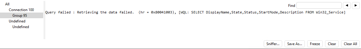

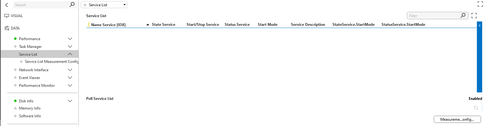

(1) Service list is not loading up as shown below:
Stream Viewer shows the WMI access denied error for group 95 which belongs to service list.

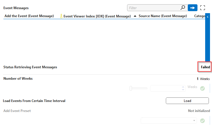

(2) Event Viewer failed to load up for 1 week of events.
There are no error logs from stream viewer, element logging to detect the issue.
