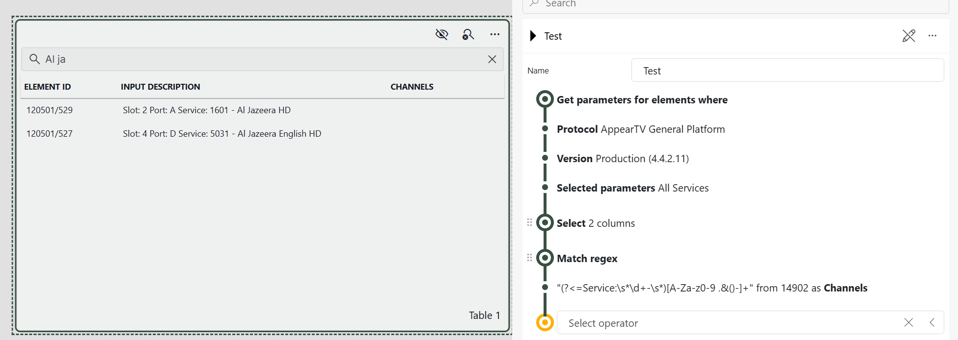

Thanks Wale for a quick answer and I have tried it, but strangely is not working in my queries. I really don´t know why.
I have done like this:

Try this as there is a space before and after the hyphen:
(?<=Service\:\s*\d+\s*-\s*)[A-Za-z0-9 .&()/-]+
Thomaz Malmberg [DevOps Member] commented 3rd November 2025
Yahooo!
That worked and you saved my day. Big thanks for your help.

Did a quick test and this should work:
(?<=Service:\s*\d+-\s*)[A-Za-z0-9 .&()-]+
See picture below. 🙁
