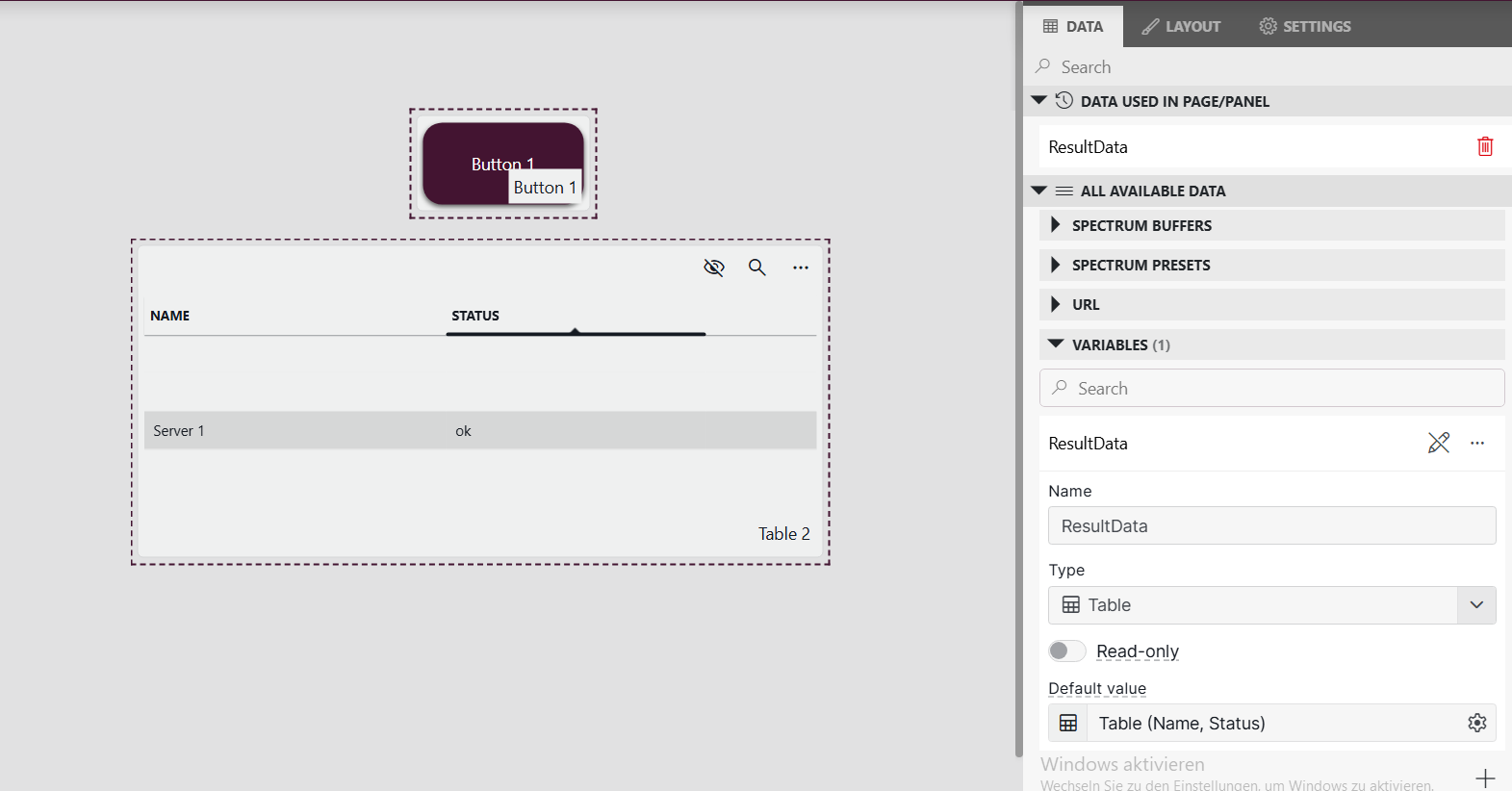

Hello everyone,
I’m trying to display some data (JSON output) from my automation script in a low-code app as a table.
Unfortunately, when I store the output in a variable and pass it to the table (drag and drop), nothing shows up.
I’m not sure what’s wrong — does anyone have an idea?

The "Server 1" example i added it in variable low code settings.

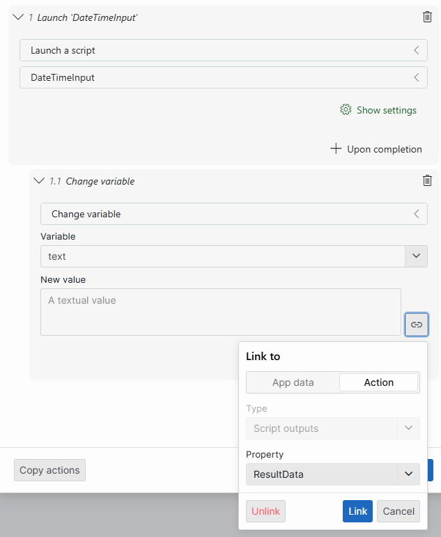

For now, only string values can be used as a feed value in the postActions of the Execute a Script action. In the future, we do plan to add support for fetching a query and storing it in a variable.
You can now do the following with string values:
This will then use the script output and put that as the text variable, you can then use this variable however you like.
Note that this is only available from version 10.5.9 onwards.

Robin Debel [SLC] [DevOps Advocate] commented 20th October 2025
I've changed my original answer and added a photo. Kind regards
Property is a box you need to type something in. In ur case that should be "ResultData". I know it looks like a dropdown, but you need to type and then press enter.
We have a task on our backlog to make this better.
Ömer Eryaman [DevOps Member] commented 20th October 2025
Confusing
Thanks for the help, it works now
I can display outputs from my automation script
