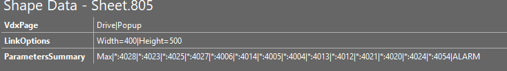

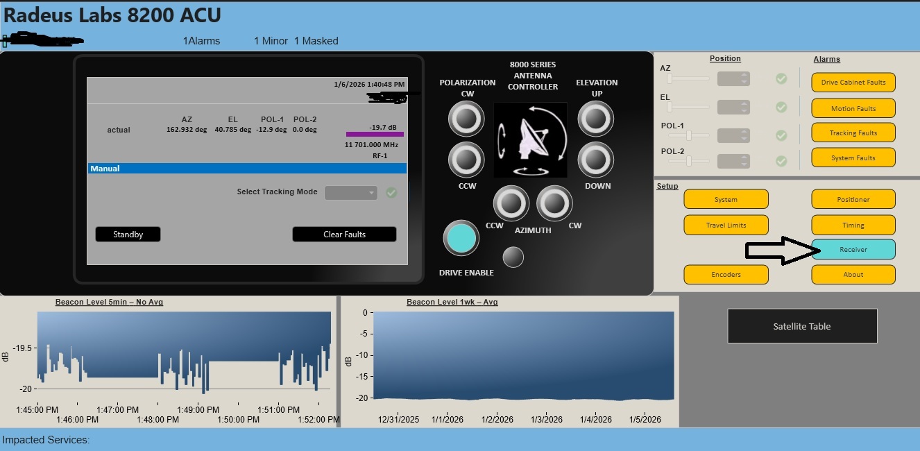

Hello.  As a user I want to have a shape, called "receiver", to show severity for the following parameters from the same element/device.  Can this be combined as one entry under Shape Data?
Protocol: Radeus Labs 8200
PID
3014
3015
3016
3017
3018
1076
1074
1075

Thanks for jumping in Miguel. We ended up going the route of "ParameterSummary" in the shape data, example below.
Originally she had another property defined on the shape "Element *" so I assume that was using the element alarm severity summary for the shape, once we removed that it worked as expected.
