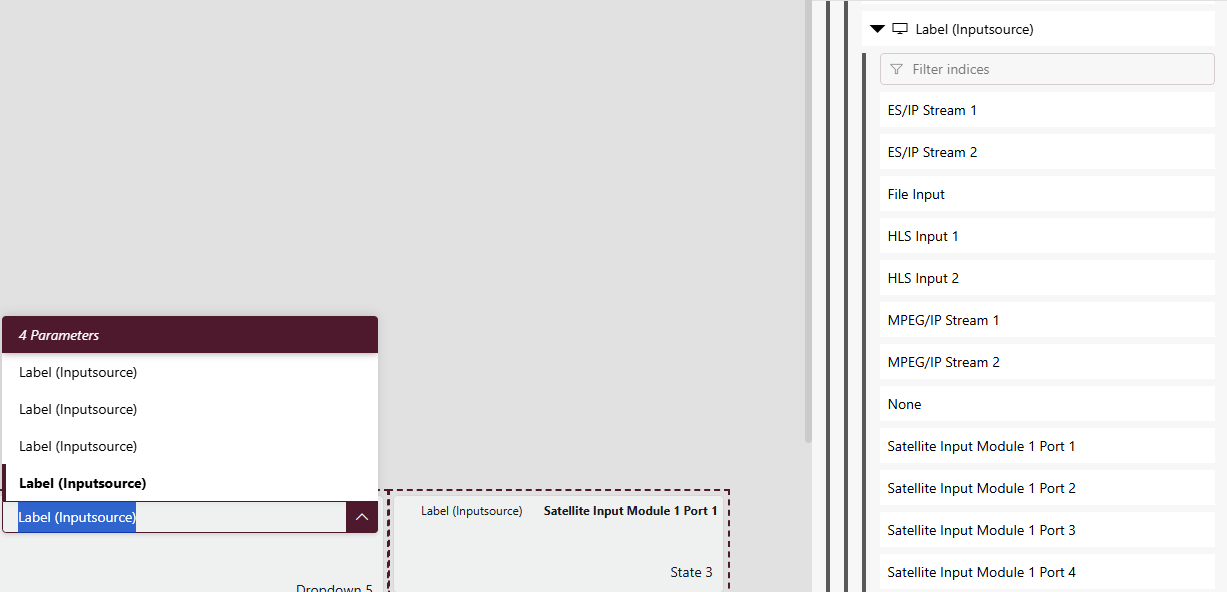

We wrote a connector for an element and want to create a LCA to control the inputs of the device with a dropdown menu.
I can choose the right parameters from the table "Lable (Inputsource)" to add them to the "Dropdown 5". But if I now try to select an input, only the table column name is shown for all added parameters.
On the right "State 3", the correct selected Input is shown after its choice on the left side.
Is there anything I can do to see the right names from the input table directly in the dropdown?
Best regards and thank you in advance!
Daniel

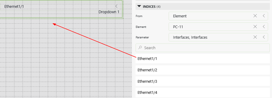

Hi Daniel,
Can you try using the Indices data source:
You should be able to list the indices:
Hope it helps.
