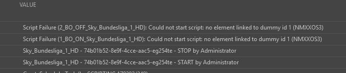

Depending on the script I choose in the scheduler, the dummy element may vary. However, when the task executes, I receive an error stating that no dummy was selected. This is confusing, as the dummy is already preconfigured in the script.

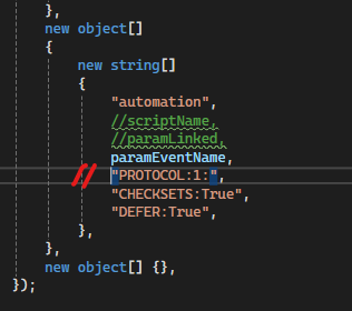

I’ve tried two approaches when creating the task programmatically:
  • Leaving the PROTOCOL:1: element empty
  • Omitting the PROTOCOL:1: element entirely

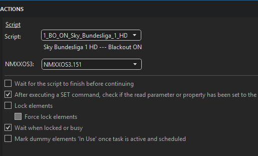

In both cases, the error persists. What's more confusing is that when I inspect the scheduled task afterward, the correct dummy element is visible (like in the second image). However, the task still fails with the "no element linked to dummy" error during execution.
Interestingly, if I manually open the "Actions" tab of the scheduled task and click OK (without making any changes), the task then executes correctly.
