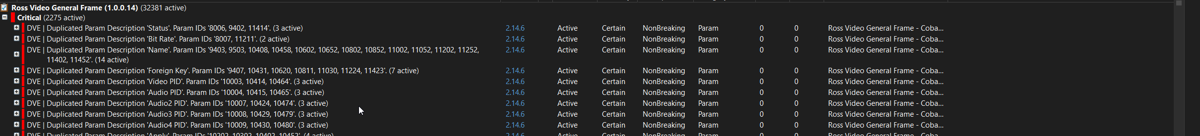

I picked a DVE connector that has not been updated in a while and DIS is throwing a lot of critical errors regarding the description of the parameters being the same.
This is due to an export rule that removes the table description in parenthesis from all tables that will be exported, even the ones that will not be standalones.
Is there a way to remove the table description from the exported standalone parameters only in a generic way? or do I have to write a rule for each table? Note: This connector has over 8000+ parameters, my goal is to search for a more optimize way before going the brute force method.
