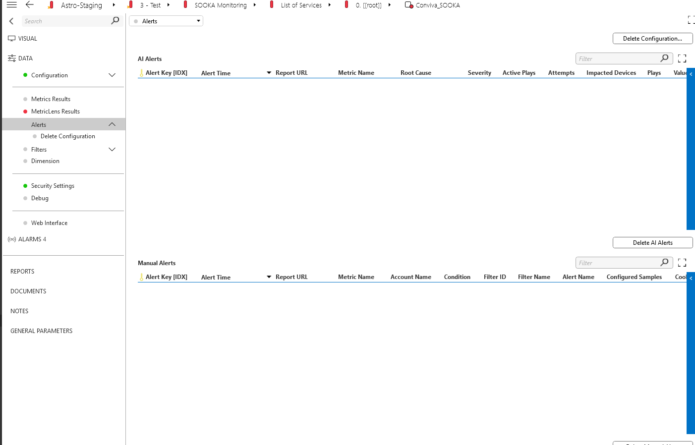

Hi, I already connected the Conviva Experience Insight connector to DataMiner, and already can see data such as VSF, VPF, Channel List and all.
Except One. AI Alert. As can be seen below,
The AI alert page is empty. When I refer to documentation (Conviva Experience Insights | Catalog | dataminer.services), it said:

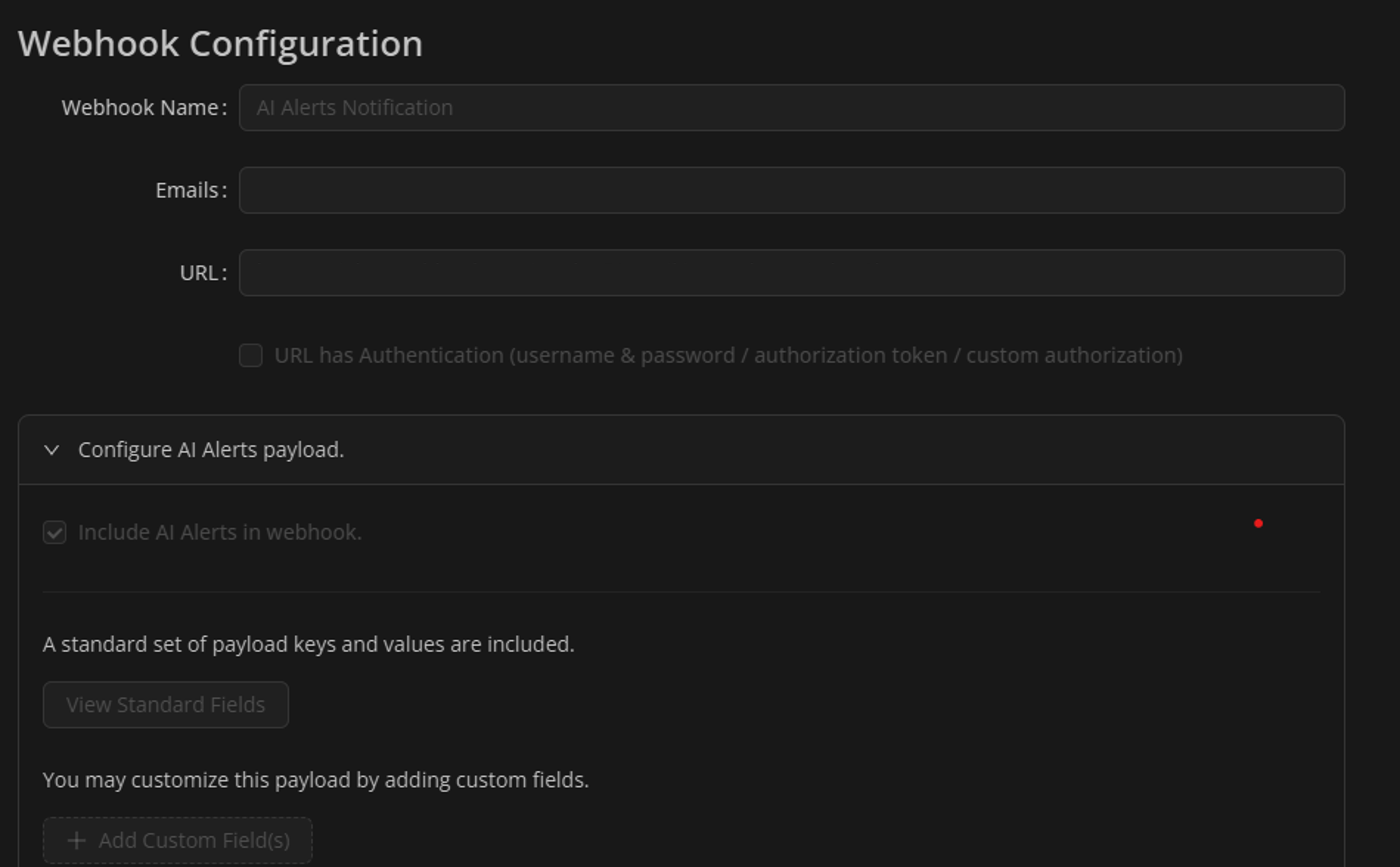

Which seems a bit vague, and I am not sure what to do next. Hence, the image below shows my Conviva Webhook for AI Alert Page:
Hence, what should I do on here? What data should I put on connector edit page?

Flavio Meneses [SLC] [DevOps Enabler]1.35K Posted 30th October 2025 0 Comments
I'm not very familiar with Conviva, but on such page, you should specify a webhook name and the URL. The URL should point to the DataMiner entry point that Conviva will contact, typically something like http://<DataMiner IP/FQDN>:<port>, where the port matches the one defined in the element wizard for smart-serial communication.
Make sure Conviva can reach DataMiner at the specified IP and port. You may need to update network or firewall rules to allow this.
Hope this helps!
