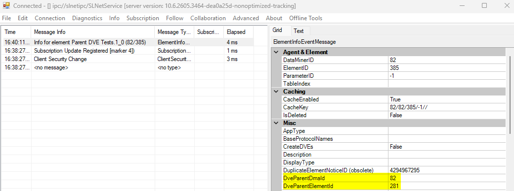

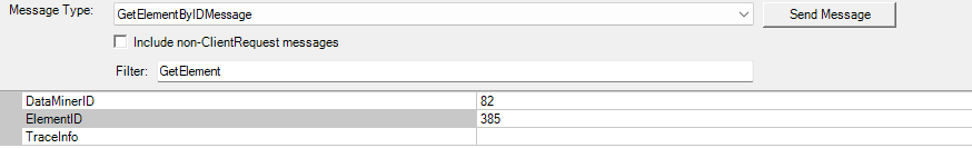

Hi Caio,
You can send the GetElementByID message via the Client Test Tool. The input IDs should be taken from the DVE element. Example:

Pieter Van Compernolle [SLC] [DevOps Enabler] Posted new comment 24th April 2026
