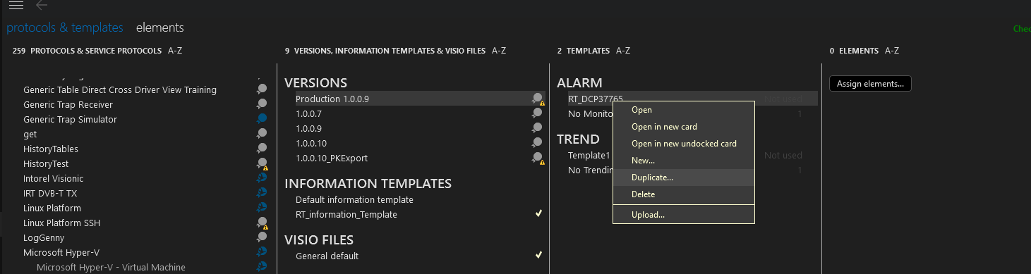

In the “Protocol & Templates” module, you can right click the template you want to duplicate. In the context menu, select “Duplicate”.

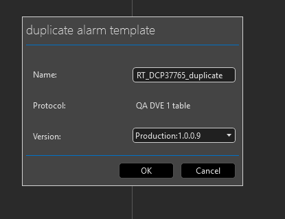

This should give you a popup where you can specify which other version of the protocol you want to create the duplicate for, as well as give it a new name.
Hope this helps answer your question.
