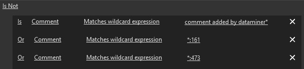

Is there a way to disable dataminer adding comments itself when monitored elements get into timeout and get cleared..?
We want to start using this built-in column "Comment" for our NOC operations instead of using a custom alarm property "alarm.tag".
We are aware of possibility using "OWNER" but this feature behavior is not what the NOC wants.
And we are testing a workaround to filter out those records that are created by the dataminer but that entails adding additional filtering onto our filtered alarm tabs...
Paulo Henriques [SLC] [DevOps Advocate]2.06K Posted 2nd July 2025 0 Comments
Hi Ramunas,
I don’t believe such an option exists. The best way to proceed would be to filter out any alarms that are not relevant to you.
