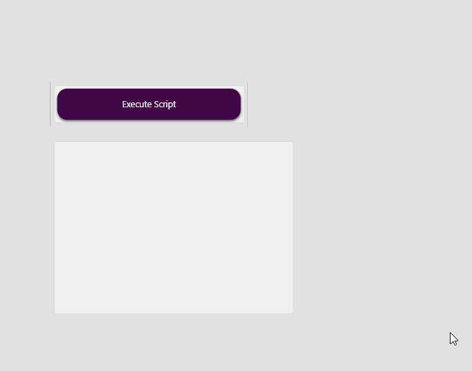

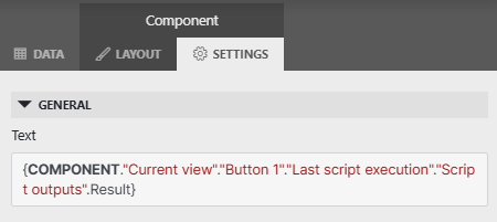

In Low-code apps, I have a button1 and a text. I also have an automation script that reads a log file. I want to show the contents of that log file in the text. So, I wrote this as the content of the text:
{COMPONENT."Current view"."Button 1"."Last script execution"."Script outputs".}
But it's not doing anything. How should I return values in my script for this to work? Am I binding the text incorrectly?
I tried this in a script, but to no avail:
public class Script
public void Run(IEngine engine)
// Generate some output
string result = "Hello, DataMiner!";
// Add the output to the script
engine.AddScriptOutput("Result", result);

Miguel Obregon [SLC] [DevOps Catalyst]24.01K Posted 15th September 2025 1 Comment
Hi Satrap,
Using your test script, I configured the text component as follows:
When clicking the button, you should be able to show the output of the script in the text component:
Hope it helps.

Satrap Shojaie [DevOps Member] commented 16th September 2025
Yup! It works! Thanks Miguel! It looks like I was missing that '.Result' at the end of my binding reference.
