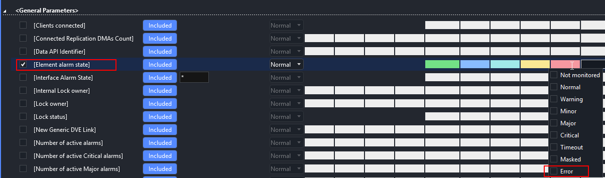

During some issues with our DMA we've found some elements in the not active (error) state. Is there a way to raise an alarm on this state? (or to find all the elements in this state)

Hi Gerwin,
I believe a possible option is to enable monitoring on 'General Parameters' -> [Element Error State]
Hope it helps.
