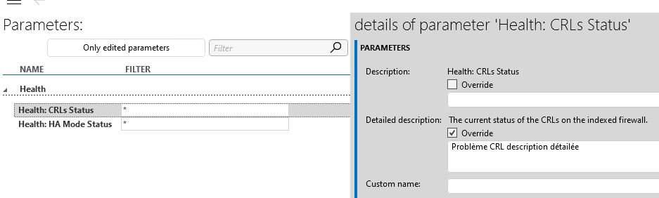

How Can i add an instruction link to my alarm ? For exampe : an alarm "Disk capacity reached" and clicking on it or overpass on the alarm to display instruction "Create a ticket to Network Support team" ?
I tried to use the "Details description" on the information template but i don't know how to display this "overrided" information
Thanks for your help.

You probably want to configure a 'Corrective Action' for that parameter? You got very close already by looking into the information template. If you scroll a little bit further down till you reach the 'ALARM' section, you'll see an item called 'Corrective actions'. Just check the box there so you can fill in 'Create a ticket to Network Support team' and apply your changes. (Please make sure the information template is active via the context menu in the 'protocols & templates' app)
If you then add the extra column in your alarm console for your operators called 'Corrective action', you should see the same text being displayed there.
