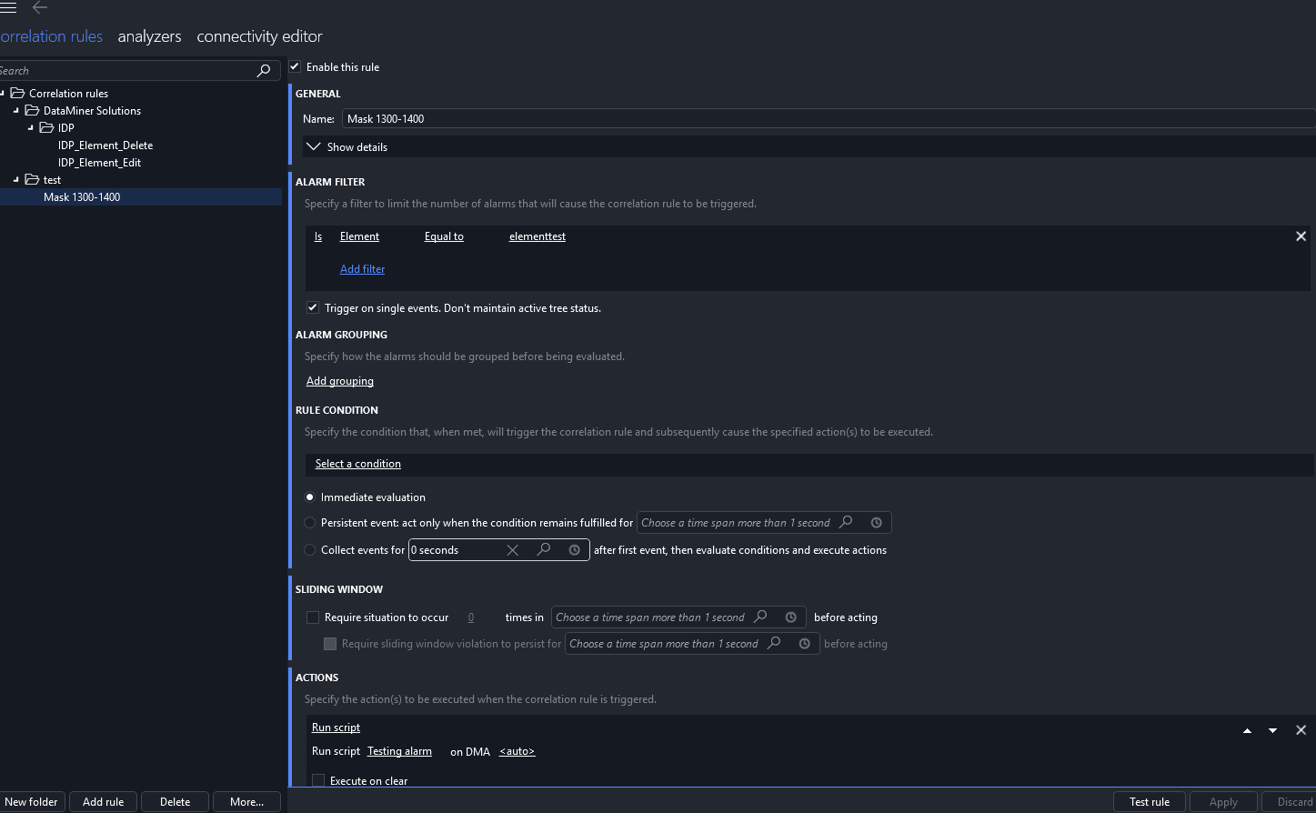

I keep getting this error. I am not sure what I am doing wrong.
The following was returned from the script:
EXIT: "Something went wrong: (Code: 0x80131500) Skyline.DataMiner.Automation.ScriptAbortException: Script parameter 65006 exists, but no value was passed from Correlation.
at Skyline.DataMiner.Automation.Engine.ExitFail(String reason)
at MaskSpecificRowAlarm.Script.RunSafe(IEngine engine)
at MaskSpecificRowAlarm.Script.Run(IEngine engine)"
script below:

Miguel Obregon [SLC] [DevOps Catalyst] Posted new comment 6th May 2026
Miguel Obregon [SLC] [DevOps Catalyst] commented 6th May 2026
Hi Deema,
To rule out any potential issue in your automation script, can you perform a test with the snippet available in the documentation (https://docs.dataminer.services/dataminer/Functions/Automation_module/FAQ/How_do_I_parse_Correlation_Alarm_Info_data.html)?
You can just copy/paste the code snippet and generate an information event for any alarm attribute (e.g. the AlarmID)
Keep in mind that the script can only be executed through a correlation rule. If you execute manually the automation script, an exception will be throw.
