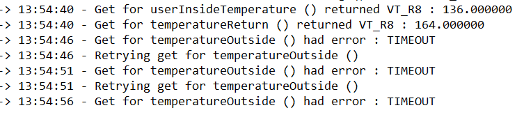

On one device variant, one of the OIDs (e.g. temperatureOutside) is not supported because the corresponding sensor is not present, and direct polling with an external MIB browser shows this OID consistently times out. With multipleGet="true", this single OID causes the entire group to fail, so none of the parameters in the group get updated.
If I remove multipleGet="true", the supported OIDs update correctly, but the element can still go into timeout periodically due to the failing OID.

With SNMPv1 it would indeed fail the entire request message. Which is strange in this case with SNMPv2 that the device does not adhere to the RFC. When polling the missing OID separately, the device should be replying with "noSuchObject", while the StreamViewer shows a timeout (=no reply at all from the device). As it seems that the device does not communicate according to the SNMPv2 specs, there is no other way to either put the 'problematic' OIDs each in their own separate group, or have multipleGet="false" on the groups where there is such problematic OID included. There is no supported method in DataMiner to handle with such kind of scenario to dynamically exclude OIDs from the groups at runtime.
