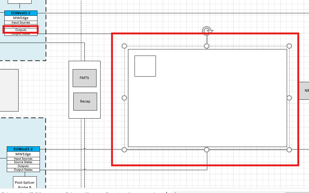

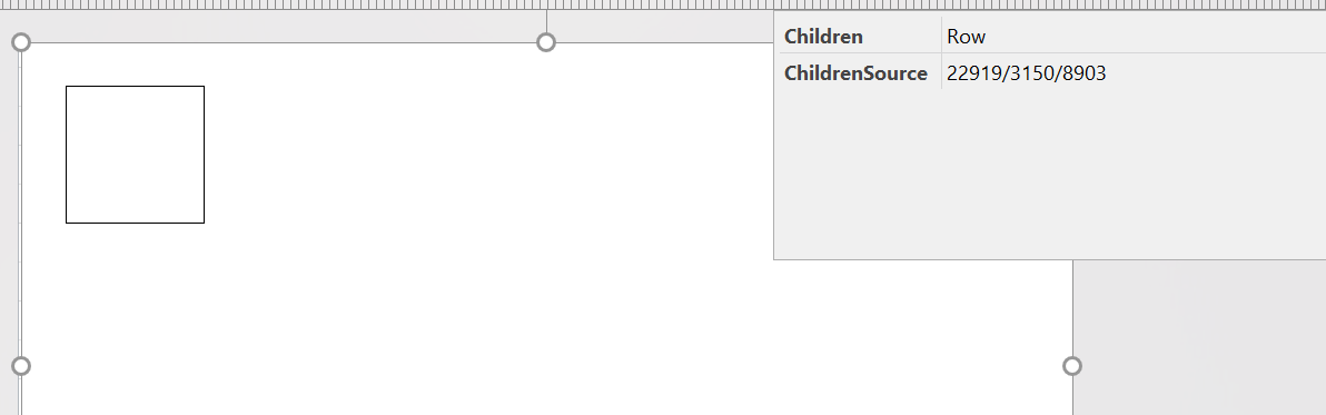

This is group shape. I used DMA/ElementID/TableID as ChildrenSource

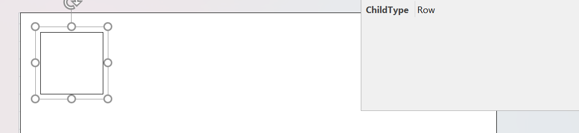

This is Child shape.
Why isn’t this working? Note: I am applying this Visio to a service element, and the Output table comes from a subscribed element (I am passing this elementID on ChildrenSource property).

Are you positive the shape that has the ChildType is actually a part of the group shape?
Ramesh Rajasekaran [DevOps Member] commented 29th October 2025
Yes. I have made sure. I have used the shape inside the group shape
Sebastiaan Dumoulein [SLC] [DevOps Enabler] commented 29th October 2025
I’ve tested a similar setup that seems to work. Please make sure the element is the one hosting the table, and the parameter is the table itself, not a column. If that checks out, I’d recommend sending this to tech support along with the Visio drawing and the connector, so that we can take a closer look.

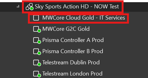

Ramesh Rajasekaran [DevOps Member]787 Posted 30th October 2025 1 Comment
I am applying the Visio to this service and passing the elementId (Mwcore Cloud Gold) along with the tableId from the subscribed element.
My goal is to read the filtered table rows from this subscribed element and create shapes based on those rows, rather than on the main element itself (since it contains many rows).
