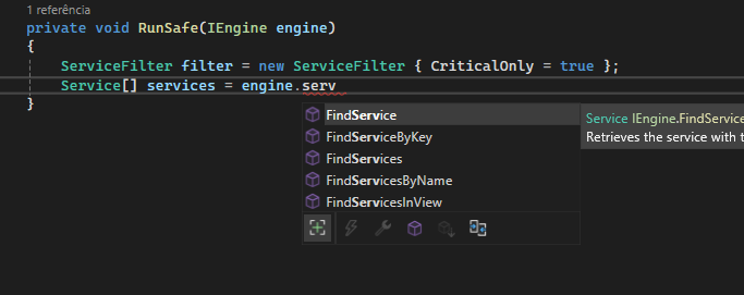

Hi everyone, I hope you're all doing well.
While reviewing the documentation, I came across the FindServiceTemplates method. However, it doesn't appear as a valid method in Visual Studio.
Is there an additional DLL or package required besides DataMiner.Automation?
Documentation link: Method FindServiceTemplates | DataMiner Docs

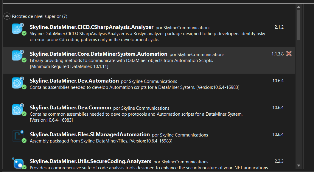

So far, I’ve tried adding the following NuGet packages:

It seems that the IEngine interface does not contain the FindServiceTemplates method.
What could be done is to try to cast it to the Engine class, which inherits from the IEngine interface and does implement that method.
Could you give it a try with:
if(engine is Engine concreteEngine)
Service[] services = concreteEngine.FindServiceTemplates(filter);
Regards,
João Azevedo Selected answer as best 17th April 2026
João Azevedo commented 17th April 2026
Hi Laurens, thank you for your response! You're right—I missed the default type when setting up the new Automation Script. Thanks for pointing that out. Implementing the Engine class worked.
