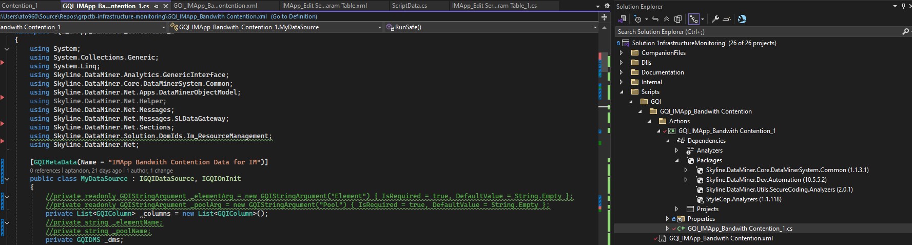

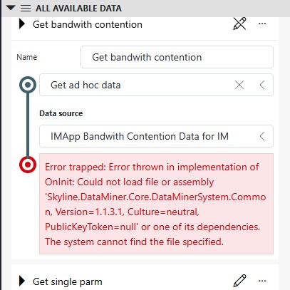

HI,
I have an adhoc data script which uses the above mentioned nuget (Core.DataminerSystem.Common), I can see build is also fine and also no errors in code, but when adding the query for the GQI and selecting that script it shows this error, although this nuget is in the dependency and in the server also on the path I can see that nuget exists, what can be issue?

If you don’t use the GQI DxM yet (supported since 10.5.5), you must have the required DLLs available in c:\skyline dataminer\files\ folder.
