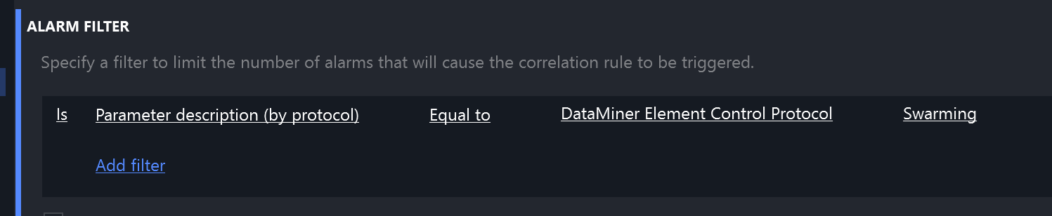

Hi Souhail,
Maybe you can trigger on the information event that is generated during a swarm action?
Your correlation rule should then be configured to accept information events and filter on the swarming parameter like this:
I also let it trigger on single events. Hope this helps?
