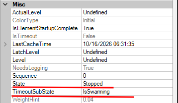

When an element swarms there is no new state describing Swarming.
As the element is restarting on another agent the state changes as follows:
Active -> Stopped -> Active (starting) -> Active (started)
However you can catch the swarm on the Stopped event (ElementStateEventMessage) as it will specify the reason with a TimeoutSubState of IsSwarming.
