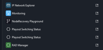

Hi Dojo,
We have several LCAs in Cube that are showing as duplicates.  I suspect this has happened as a result of copying them from our Staging DMS.
The Apps shown in Cube open the same LCA.  Can anyone suggest how we can edit something to remove the duplicates?

Wout Mahieu [SLC] [DevOps Catalyst] commented 19th August 2026
Hi Dave, do they also show as duplicates on the home page of the web apps? (https://DMAIP/root)
Dave Keller [DevOps Enabler] commented 20th August 2026
Hi Wout
No, they only appear the once when viewing on the home page of the web apps.
Wout Mahieu [SLC] [DevOps Catalyst]12.47K Posted 21st August 2026 0 Comments
Hi Dave,
I suggest you try to restart IIS and check if that resolves the issue. If it doesn't work, you can contact tech support (support@dataminer.services) so that we can look further into the issue.
