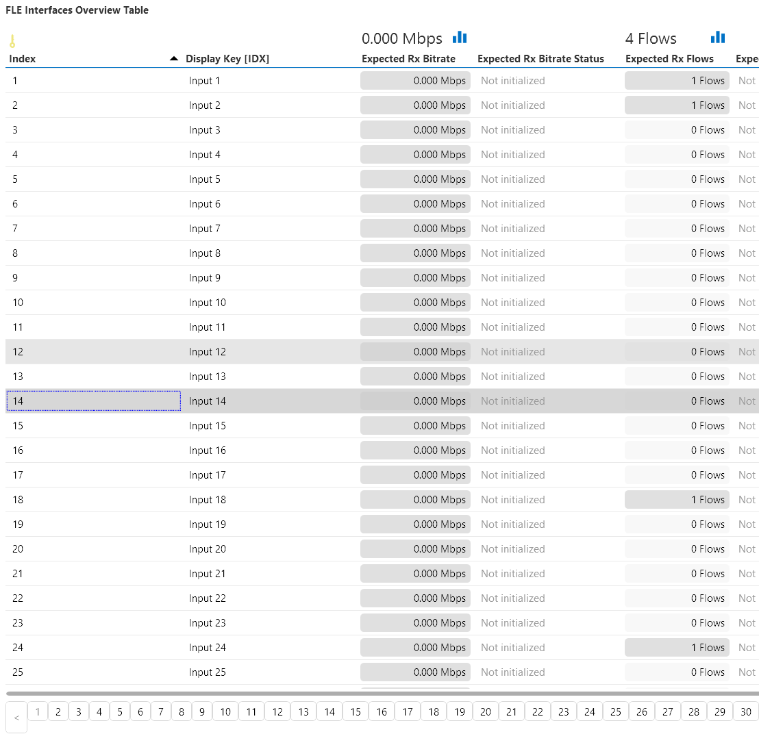

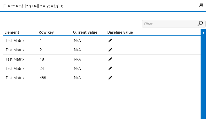

Hello Dojo,
When enabling Absolute baseline alarming on a partial table, the behavior does not seem to work correctly. So far I have noticed that the current value is not being filled in and is showing not initialized, other times only a small amount of the rows are shown.
When I remove the partial option from the table, the baseline details table fills in correctly.
Does baseline need additional settings to work with partial tables?
Below are pictures showing the baseline table and the table that is being alarmed (Expected RX Bitrate is the alarmed column).

Miguel Obregon [SLC] [DevOps Catalyst] commented 25th February 2026
Hi Gabriel,
It seems expected behavior.
See DCP253128.
Luís Freitas [SLC] [DevOps Advocate]1.08K Posted 6th March 2026 3 Comments
For everyone’s clarity, as Data-Core member, I confirm Miguel's assessment.
The described issue is being addressed under the internal task DCP253128, which is currently in the backlog of our Cube Team in a "to be scheduled" state. This means that we don't yet have a target release date for the fix.

Simon Vandamme [SLC] [DevOps Advocate] commented 20th March 2026
For transparency, the conclusion is that the baseline feature is currently not supported on partial tables. We will update dataminer docs accordingly.
